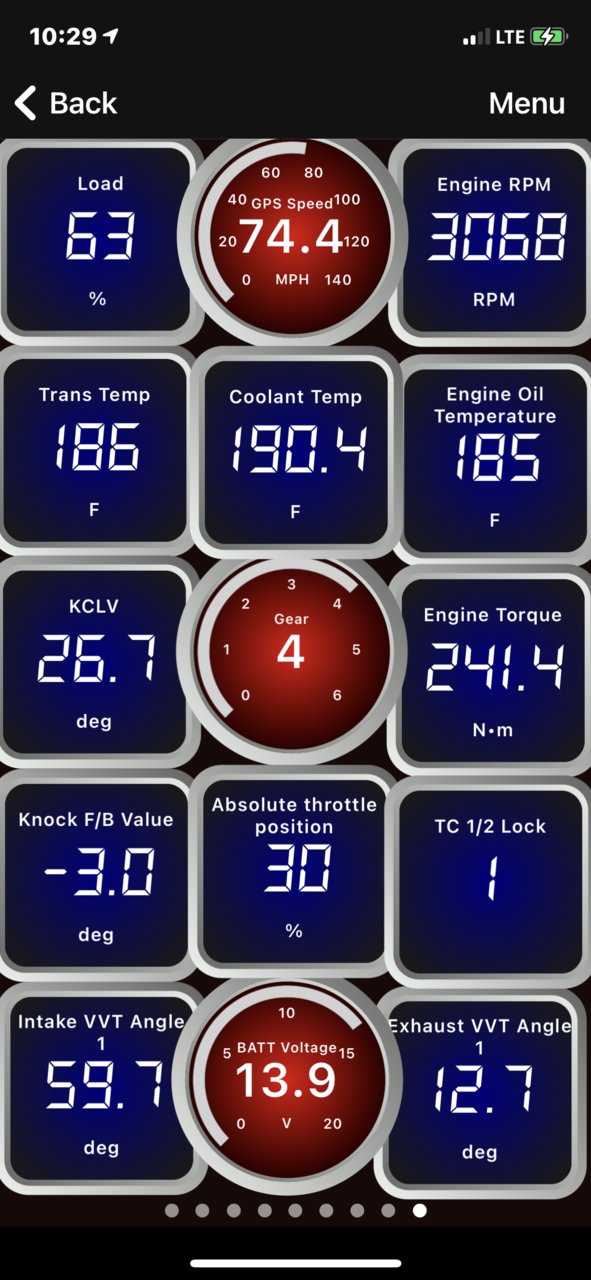

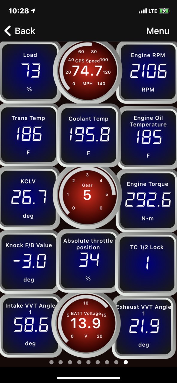

    Drove 150 miles today to our Hunting camp. On hilly highway. Here’s some numbers. On OBD Fusion app.
    Downshifted at 88% load from 5th to 4th. In Cruise Control.

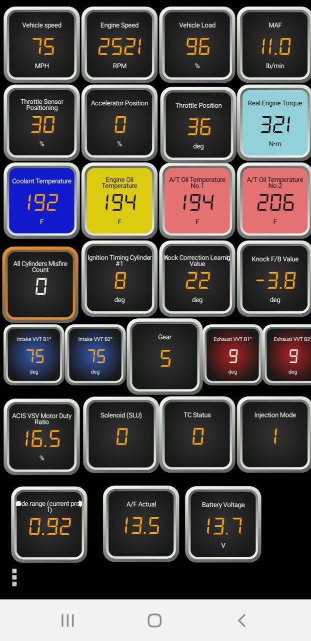

    6th slight grade

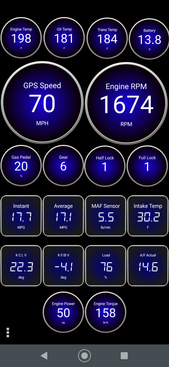

    Hwy cruising

    The load is 20% less..

    Also a gear higher. A 16% or so lower ratio.
