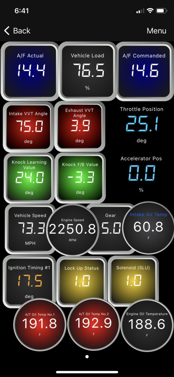

    Since everyone else is posting theirs. Here is a hwy pull up a hill where I would very often drop down to 4th gear. This is with CC engaged. Let me know if anything seems off. Still new at this OBD Fusion monitoring.

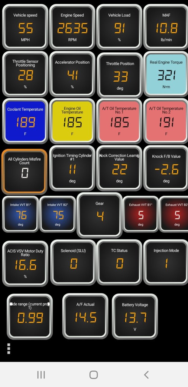

    Found a steeper hill... :D
