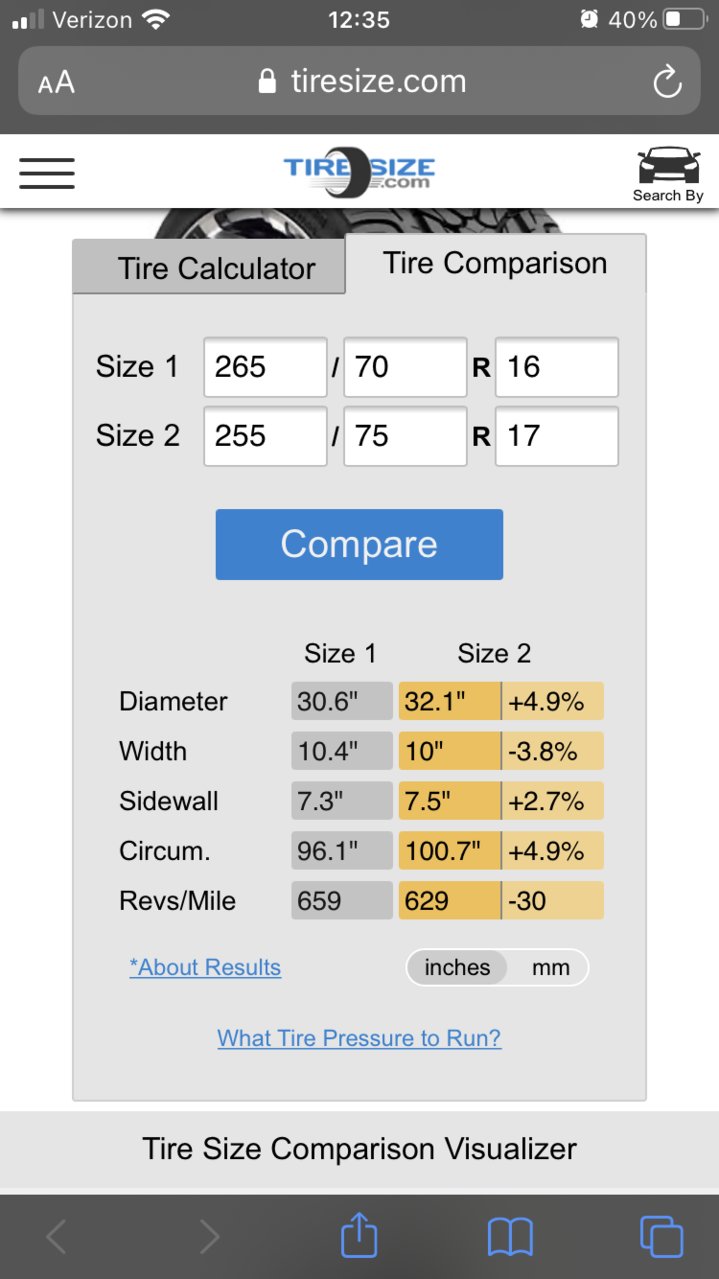

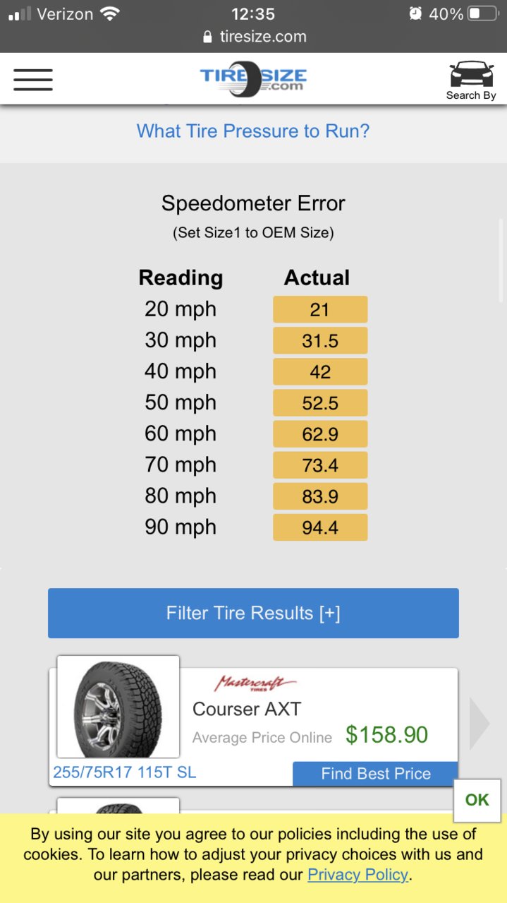

    what? With 32’s my speedo is off by 4mph at 90mph! With such a slight increase in tire size you shouldn’t be noticing that much change. This chart is accurate for me (even tested with police radar)

    Love that website. That's why I'm thinking maps vs speedo. My 33s are off by 5ish mph at 60 according to GPS

    doesn’t bug me enough to want to change it if you know how much it really is in the speed spectrum (kinda like distance with Kentucky windage)

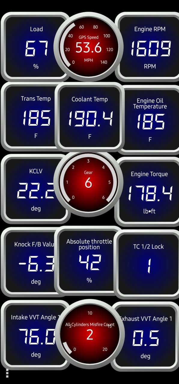

    I'm going to go do a bunch of logging on 85 then get premium and log again. If kclv goes up to the 20s instead of 19 with premium then I think premium is the answer.
    Mooseditty17 likes this.
  13. Jan 25, 2021 at 12:57 PM
    #1193
    Chadr7858
    Chadr7858 Well-Known Member
    Jun 13, 2014
    #131908
    1,884
    Chad
    Colorado
    19 TRD SHIT BOX, 02 BEST GEN
    All the mods; all the problems
    I'm also going to run 2.0 and monitor kclv and see if their is a difference

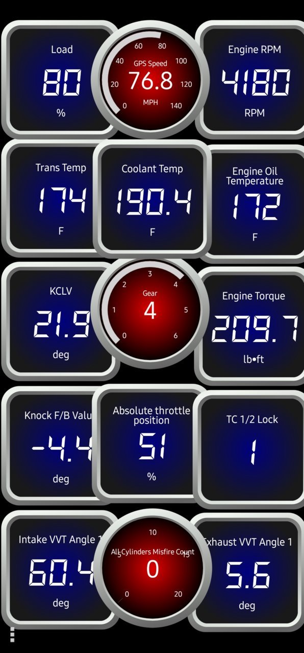

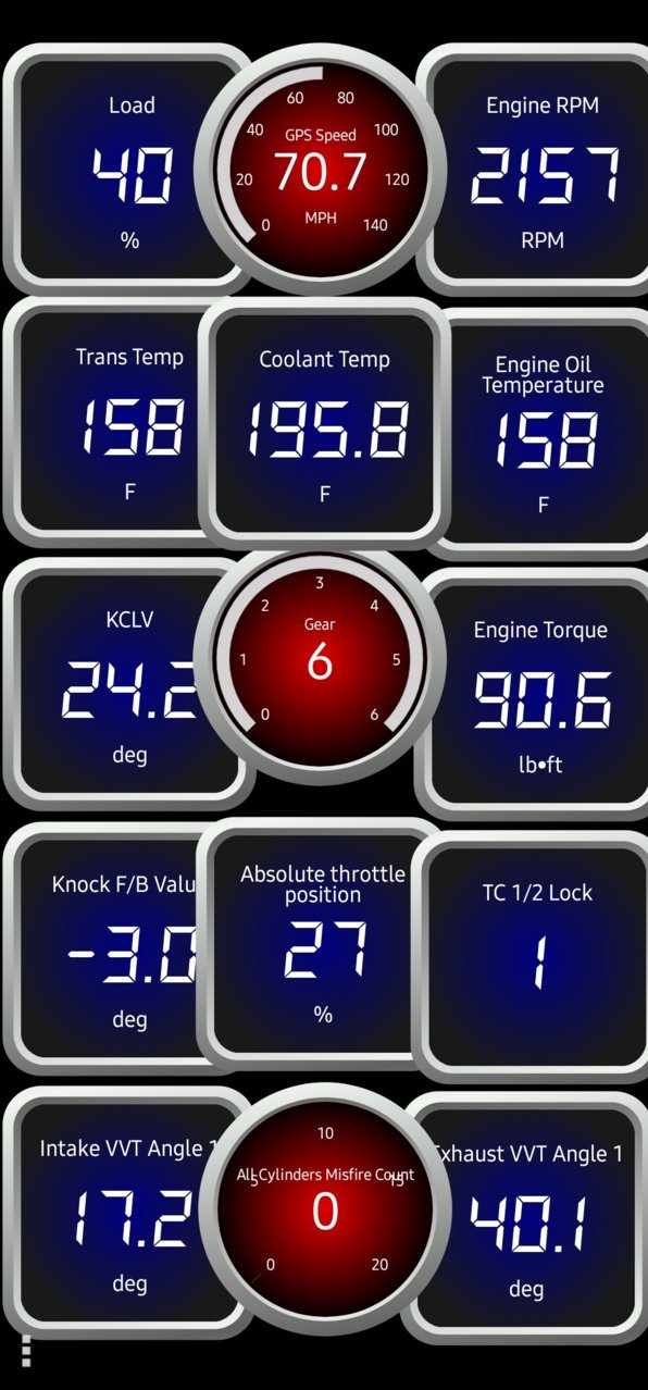

    Cruising low speed high load
    Cruising highway
    High load high rpm acceleration

    I believe I'm suffering analysis paralysis... I too have seen similar values. On a 30 mile trip with city, hwy, high and low loads, it still averages -3.156 for a f/b value

    Good looking Dashboard! Looks familiar, lol.
    Glad you could use it.
