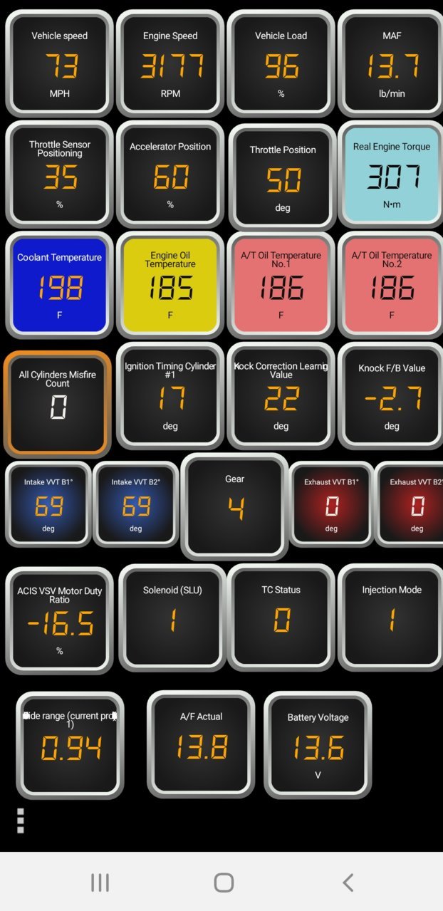

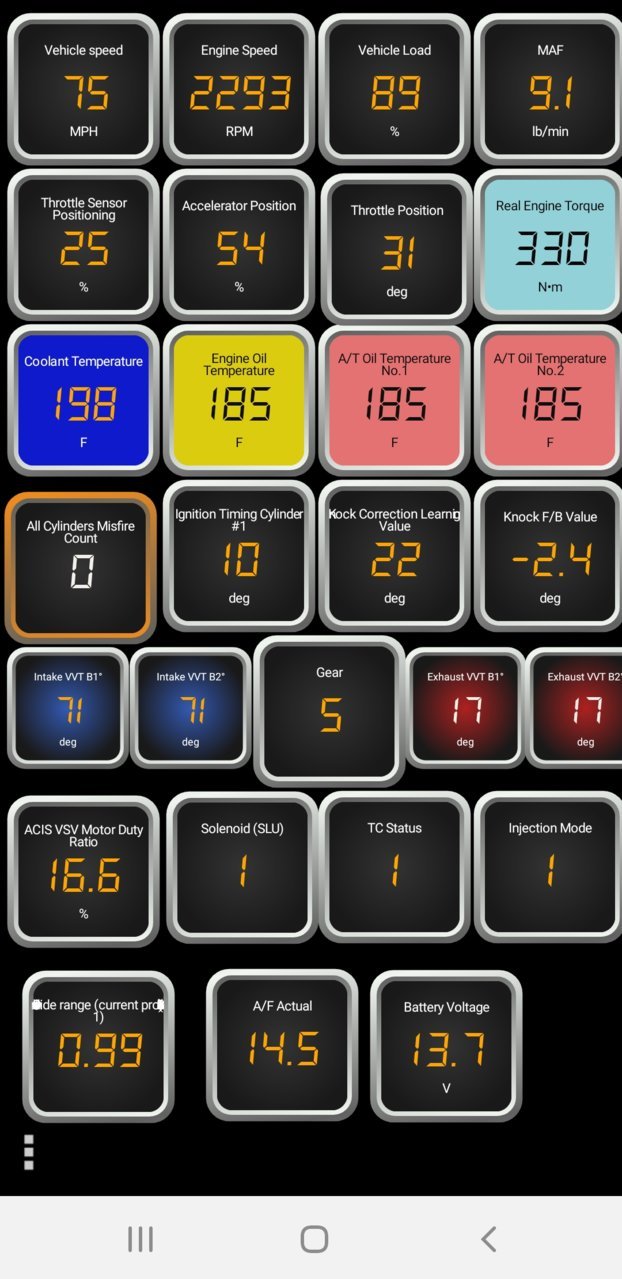

    I got an opportunity to drive 2 versions of @PapaRee latest tunes. Overall both are very good tunes, drives very well on the freeway. There are minor changes were applied to the throttle and I also shortened down the 4th upshift( to long for me) and with that I had to bumped up the tc locking speed by 2-3 point for 5th. So this small changes took care a driving on windy slow roads.
    As far as freeway driving and driving above 70 mph while climbing.
    Downshift 6 to 5 is in the right spot, about 32* of accelerator.
    On the moderate and long inclines the things are a bit better compare to my versions, but not quite what I want.
    Both versions are allow you to push the accelerator to 60 % (airload control tables vs 2.0 original) and I get about 100 rpms more. As usual, you start loosing the momentum before the top of the climb. TC stays fully locked.
    More accelerator does not a thing, no increase in rpms and the truck downshifts to 4th once you reach 95%(3rd image capture right at the downshift).
    After that you will get the same issue - wont upshift until you get to the flatter part or select S and it will upshift. 4 to 5th upshift works at speed at or below 65.
    CC worked fine on. I think i got a downshift at 77 mph on the same spot. Wont upshift unless lower the speed by CC control.
    I drove 1st version (2nd image) with empty tank and felt good. 2nd version(1st image) was with a full tank and felt a bit sluggish to me.
    The main issue is non working downshift to 4th at speed above 70. I tried different # in every direction and it would not work in D. I guess I can drive in S or w/CC on.
    So the tune is solid, but you may need to adjust to you preferences. 1st version has a touchy throttle and a long 3rd and 4th. Both are easy to correct and no big deal.

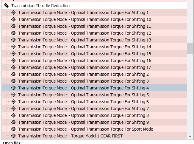

    When you guys tune these shift points are you also doing the transmission TORQUE maps? (3D)
    you need to focus on the torque maps where / when it doesn't shift how you want

    Are you talking about these? I have no idea how to adjust them. Any instructions?

    yes. I have explained what to do with them a few times, but if you want more in depth information please go to our forum.
