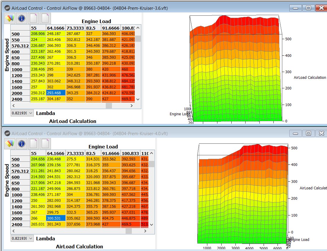

    So. I fixed the dip and used a different accel trottle request set of values.
    The same hill tested. Numbers are very close, some better by a small margin. Overall, there is no significant changes.
    The downshift to 4th was pleasant. The rpms did not shoot up to 3500, instead it was a gradual increase and then you can see/feel acis kicking in. I switched to S and upshifted to 5th @3500
