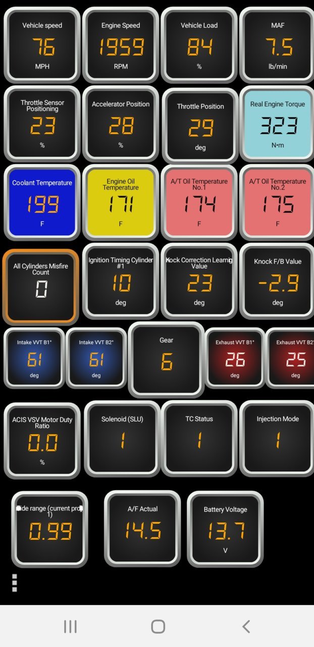

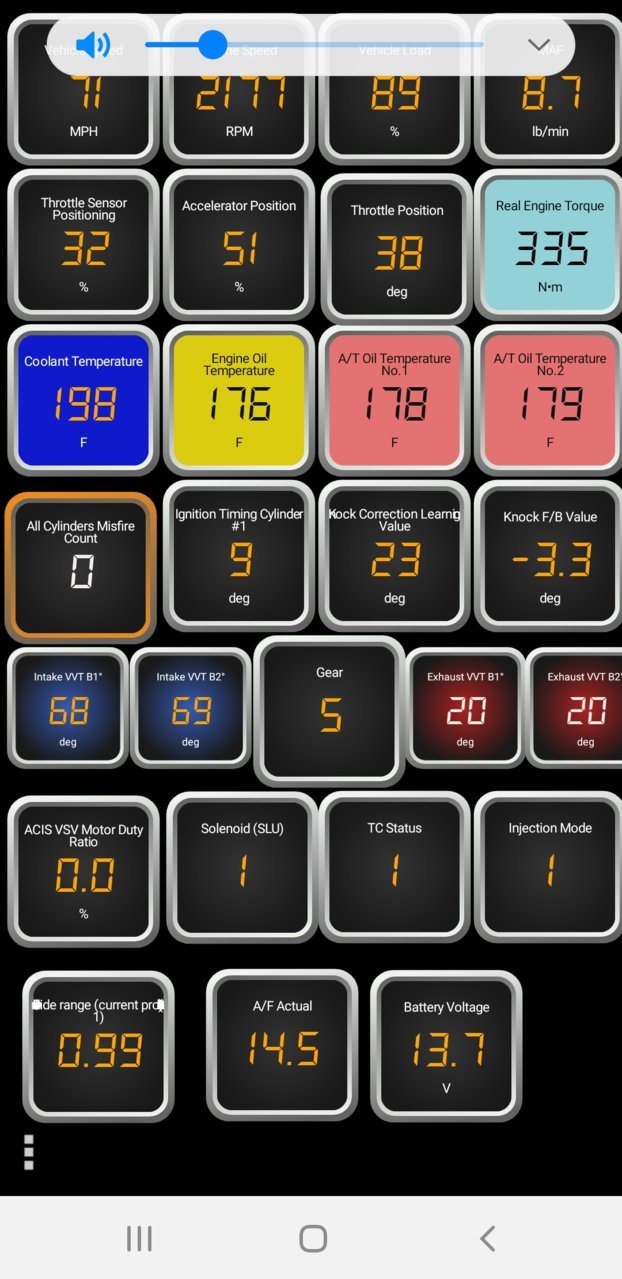

    Here is a question. We jacked up numbers in all known places, but why is the throttle still being limited between 85 -90%.
    Here is an example of the accelerator and the throttle are being neck to neck and far apart.
    There is only 200 of rpms difference and 5% of the load, but the difference between the accelerator and the throttle position is uuuge.
    I know that there are limits, but can we milk another 100 -150 rpms out by opening the throttle just a bit more? This will be a huge improvement w/o going unlock tc route.
