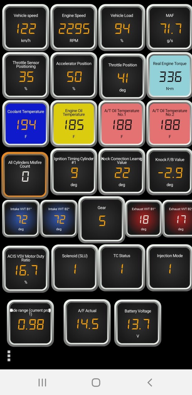

    I think you're referring to a different PID than what he is talking about. Throttle Positioning Sensor maxes out around 82% but what he was referring to was the vehicle load which does not max out at 89%, vehicle load can go over 100% if you're romping it at higher RPM. This is something I'm trying to work through at the moment because it seems I cannot achieve 100% vehicle load at lower RPMs. I've tested two files that open the throttle at 29% and 81% at full demand 1600 RPM. MAF reads the same, vehicle load reads the same on both. RPM matches, speed matches, gear and TC status match. So it may just be that it cannot actually achieve 100% load at certain RPMs due to other limitations. The testing continues..
    But I just didnt want want people to start running their loggers and asking why they arent hitting 89% as you mentioned. Wouldn't 89% throttle matching the degree also imply that 0 means the valve is completely closed?

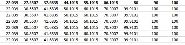

    So I went and jacked up the numbers in throttle Limit gear S tables for high angles . I got the sensor a bit closer to the accelerator and I open the plate by a whopping 1 point.
    So, I already have Accel throttle request table set to a vertical line + changes to throttle limit table produced a minuscular gain, probably due to less gas in the tank.
    I bet airload tables need a revision. thinking of moving the hump past 2400 rpms, but not sure what to do with Expected. I'll dive into fixing downshift to 4th at high speeds/loads.
