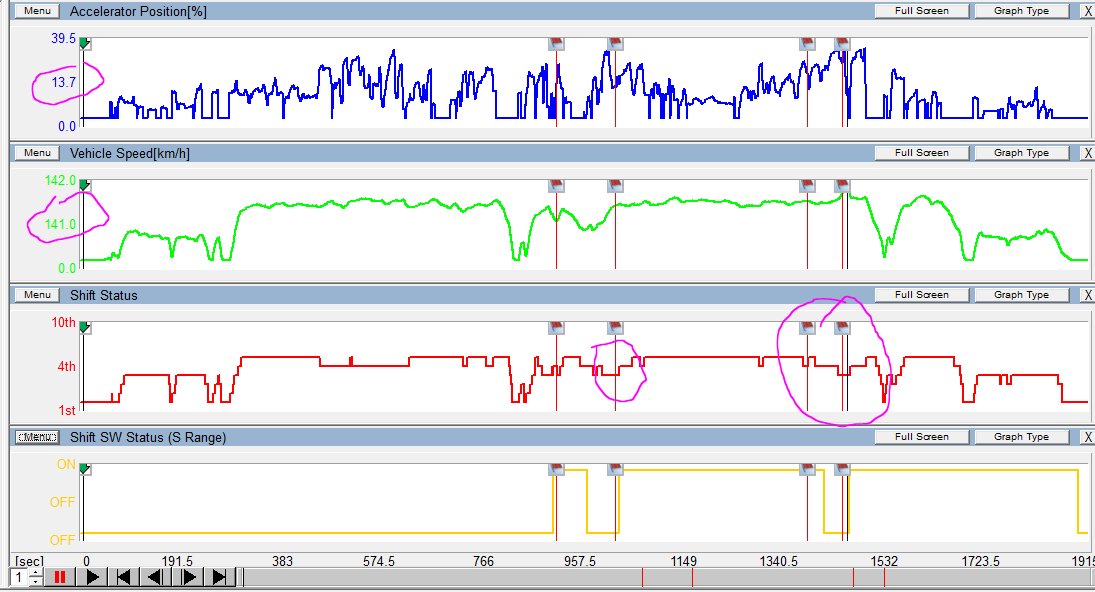

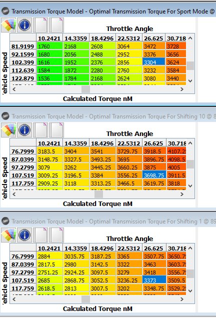

    Are you sure this is a delay, and not the effect of the 3d torque maps affecting shifting at high throttle?
    As Vlady is so frustrated by the truck DOES NOT always shift at the intersection of accelerator and speed specified by the 2d shift schedule maps.

    Mat has stated that raising the values will make the truck more likely to upshift in the given conditions. You will need to determine what values work for you.

    By delay I dont mean its just at high throttle. It happens at just about any level of acceleration. Parameters are met to trigger an upshift so techstream shows an upshift. But a short period after that, the transmission upshift actually occurs. It may have to do with the torque maps or another parameter we dont yet have access to in the ECU/TCU. Cant confirm that.

    Gotcha. Perhaps the 2d maps are gates one must get thru to shift. Then, once thru, the torque calculation takes over and determines what the torque generated must be to shift. Pass thru the gate with too much or too little torque, and there is a delay waiting for the engine torque to match the specified torque in the table.

    Ok so if you want it to upshift to 5th at 55MPh and 29% pedal, change the cell under 31% pedal to 62.5. This will create a pretty flat curve for the upshift but it should be purely used for testing. I tried to simplify it as much as possible for you by only making you need to change one cell. Try it and let me know if it doesnt work.

    Ran the map with your suggestion. No joy. I reached 80 in search for that shifting point.
    To clarify. I'm expecting upshift at speeds above 65. Example below -accel 14 -speed 80
    Also , if in S, this caused the tranny got caught in the shifting up/down loop on the incline.
    Also ran a map for optimal shifting 1 w/increased values b y 5%. No impact on upshifting . It seemed the shifting is better, but caught myself thinking that it may holding gears a bit longer than before.

    Why did you only change map 1? You gotta change all of them.

    For given throttle/speed where I'm expecting the upshift, table 1 has lower # compare to table 10 profile.
    Just FYI, original 2.0 "final" has exactly same issue (you can find me bitching about and comparing to B03). So this is not "tuning" induced issue.Most like the logic is not there

    Right. Thats why Mats wants to release the torque based shifting patch. To improve the logic.
