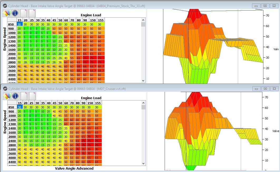

    Fine tuning the intake has been a thorn in my side. Going to have to try the Atkinson's cycle ignition timing first and see if that helps. Retard the ignition timing a couple degrees at a time. Regardless of what I have for base intake valve values, it's alway area that craves attention. 16-1800 rpm and 60-70% load

    @OVTune
    IF you or anybody else is able to point me in the right direction I would be SUPER grateful!!
    Included link is a fairly typical log and attached is my intake adjustments vs stock. All my spark control tables are 04B04 "standard" 2.0 tune values. This is also posted on VFForum
    EDIT: Looking at your sample "torque maps combined file" The areas in which I experience pinging appear to be retarded slightly vs the stock values on the ignition timing base map. Did you also notice this anomaly?
    https://docs.google.com/spreadsheets/d/1zElVjalfxpzDsF4wwhTRKaLq8QQIV9yjrut_543BOBc/edit?usp=sharing
