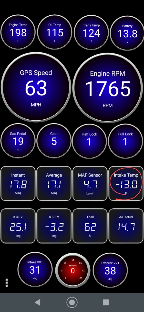

    Cold up in the Northwoods. Best way to make lots of power.

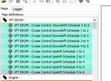

    That's a good sight to see! First thing when you open up a tune also!

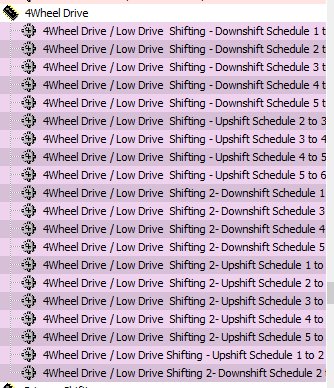

    Also there are a ton of new tables that I don't even know where to start messing with...

    Not by my computer. Is there ECT cruise control as well???

    2018 Quicksand Tacoma TRD 4x4
    Ovtuned
    I didn't see CC shift tables specifically for ECT. But maybe these tables work for ECT also or would that be too much of a perfect world? Only other different shift tables I noticed were for 4WD.
    ktbell444[QUOTED] likes this.

    ᚺᛖᛚᚺᛖᛁᛗ
    The ones you initially took a screenshot of probably do both. I'm hoping to have different shifting for Normal/S and ECT for towing.
