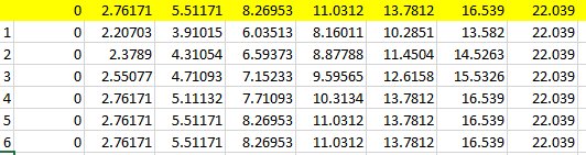

    Regarding issues 1 and 2, get Throttle limits S tables values into the spreadsheet.
    Make sure t there are no big gaps between gears for the same throttle angle.
    Make values for first 3-5 cells for gears 1-2-3 less by 10% up to ~20 angle, keep going down if still not satisfied with the throttle sensitivity. here is an example below. As far a s a rough idling, reset Learning values for the engine and the tranny. The tranny will take about 200 miles to settle, engine wont affect the "driving experience".. When monitoring idle, turn off the AC and defogger. Should be around 560 in D and 600 and change in P.

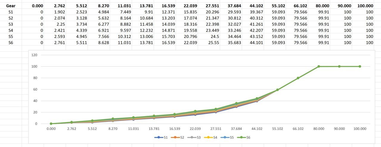

    Also, I recommend using Excel to fine tune and visualize things as well. The vF charts and graphs are nice, but when tweaking things they don't update until you save, close and then reopen the map. In Excel, you can see changes instantly.
    Example: S Throttle data set Vlady shared with me a few weeks ago:

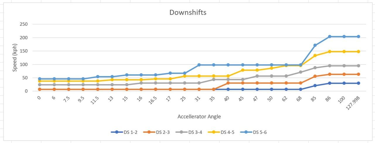

    Speaking of graphing things in Excel. vF doesn't provide any visuals for shift points so I've been tinkering with that to see funny business there. It's harder to graph because for each gear the X axis values can be different, so to get all the gears on a common scale takes some tinkering. Below is an example of some shift points I'm running now. I need to think about it more, but seems weird to me where some gears touch/cross over or get close together like 5/6. Wondering if that is a good or bad thing? Still thinking through it.

    I drove 4_5 upshift and 5_4 downshift points crossing over and there were no issues... well, I never experienced any issues.
    Worse case you will ended up in the shifting up&down loop, like a did a few week ago

    Yeah, but you’re not afraid to flash things and just send it.
    I sit and stare at graphs thinking about the effects and consequences for 2 weeks... I guess I need more flashing and sending and less graphing and thinking.
