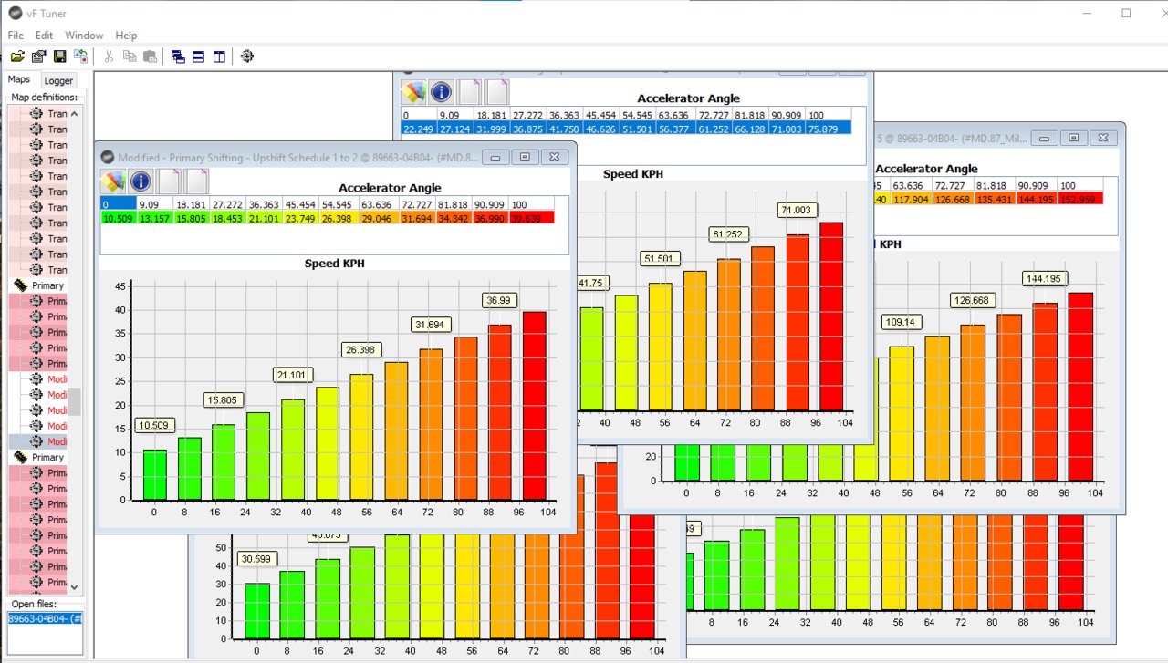

    The more throttle you give it, the longer it holds a shift. Wouldn't this be ideal? Lets talk about it.... :argue:

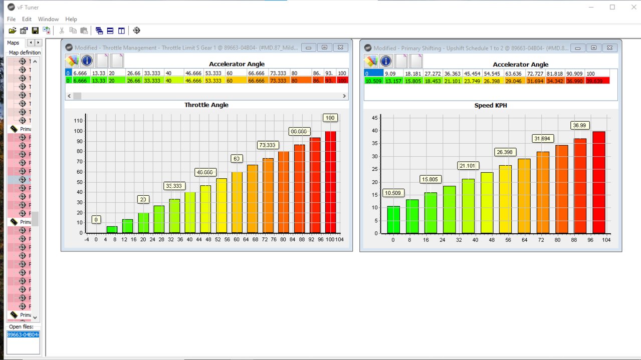

    Another thought...
    Why would this not work? It would certainly have a sensitive throttle, but nearly mechanical like output, no?

    I've thought about this, but my guess is that as driving in traffic, every time you let your foot off the gas a little it's going to shift. So probably for at lease the first third of the shifting table you're just going to want your minimum speed set for that gear.

    I don’t know about exactly these values but I agree you are onto something.
    The taco shift schedules are too slow early in the pedal travel, and too fast late in the pedal travel. Thats why in the same truck you can have it feel like it won’t downshift at times, when other times you will get unwanted early downshifts.
    First thing I did with vF was speed up the early part of the shift schedule. I am now working on slowing down the later part.
    For example, cruising in 5th gear and need to pass, stock it was very difficult for me not to trigger a double downshift to 3rd and have the truck rocket forward. Not good in slippery conditions. Decreasing the 3-4 downshift schedule at 60-75 mph range is allowing me to grab 4th and control my rate of acceleration with the throttle instead of with the trans. Much safer.
    For me it is becoming more and more predictable what gear the truck will be in at all speeds and pedal positions, making for a much more enjoyable experience.

    Until your backing up a heavy trailer but I agree.
