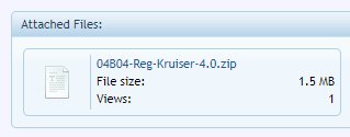

    Living here in Ft. Lauderdale my daily speeds rarely exceed 45 mph as we are all stop and go down here especially during the winter season when the snowbirds and tourists come to town. With that being said the OV 2.0 tune was not working for me mainly because of the torque converter (TC) engaging in 3rd and 4th gears. The truck had absolutely no power in 3rd and 4th with the TC engaged.
    THIS TUNE IS FOR 04B04
    I worked with Mooseditty17 over the course of a week to design a tune that better fits my driving needs in stop and go traffic.
    My tune, which I've attached to this thread for anyone to try, completely eliminates the TC in 3rd and 4th gears only. No more do I roll around a corner at 20mph hit the gas and the truck just falls on its face. Now powering out of a turn is fun, in the right gear, with the right rpm's with plenty power. The TC engaged in 3rd and 4th at low speeds was just crippling the truck.
    I next changed some of the up shifts. 1>2>3 is unchanged from the OV 2.0 tune. 3>4 is now at 30mph; 4>5 is now at 47mph; and 5>6 is now at 62mph. At speeds below 20mph the transmission immediately downshifts to 3rd gear for plenty of take off power. Mooseditty17 also added a good amount of pep to the peddle. Punch the gas pedal now and the truck jumps.
    I've now been running this tune for about 2,500 miles and for me, it works perfectly, no more dead spots at low speeds and the transmission is always in the correct gear. In town the truck averages 18mpg and on the freeway I'm averaging 21mpg with a recent run to Orlando in 60 degree dry weather I recorded a sustained 23mpg.
    Additionally, the 2>1 downshift transmission clunk during the warm up phase has been greatly reduced.
    Again:
    No TC in 3rd or 4th
    Speed changes in 3>4, 4>5 and 5>6
