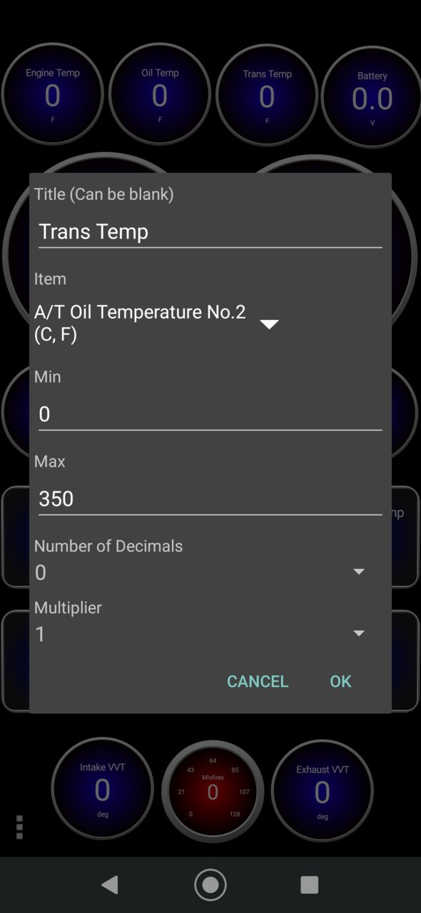

    That PID is torque converter temp not fluid temp. Torque converter heats up when unlocked because science. If your pan temp is going much over 200... :anonymous:

    Issue is TC temps. Pan is fine. TC temp is building up when fully unlocked (slu =0, status =0). I went past 220 a few times testing tc unlocking in 5th on the climb.The pan remained at the thermostat range.
    Again, once SLU is on , the TC temp will drop really fast

    Issy, WA
    2017 White SR5 DCSB V6 4x4
    Not really, just not comfortable not knowing what exact temp limits are..
