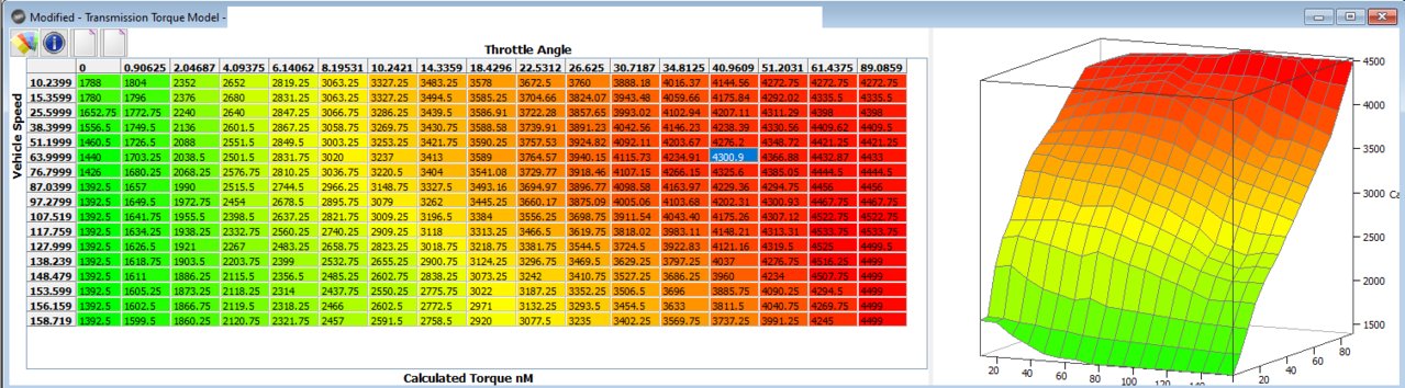

    I just got off work it will be about an hour before I can get those tables to you. Let me know if chaddr beats me to the punch

    Where did you find hp peaked?

    After we combine likenesses we then make that the map for all tables but sport?

    @OVTune
    Once the maps are combined, are all maps 1:17 supposed to be the same combined likeness values? (like we do with shift maps)
    With the exception of the "sport" map?
