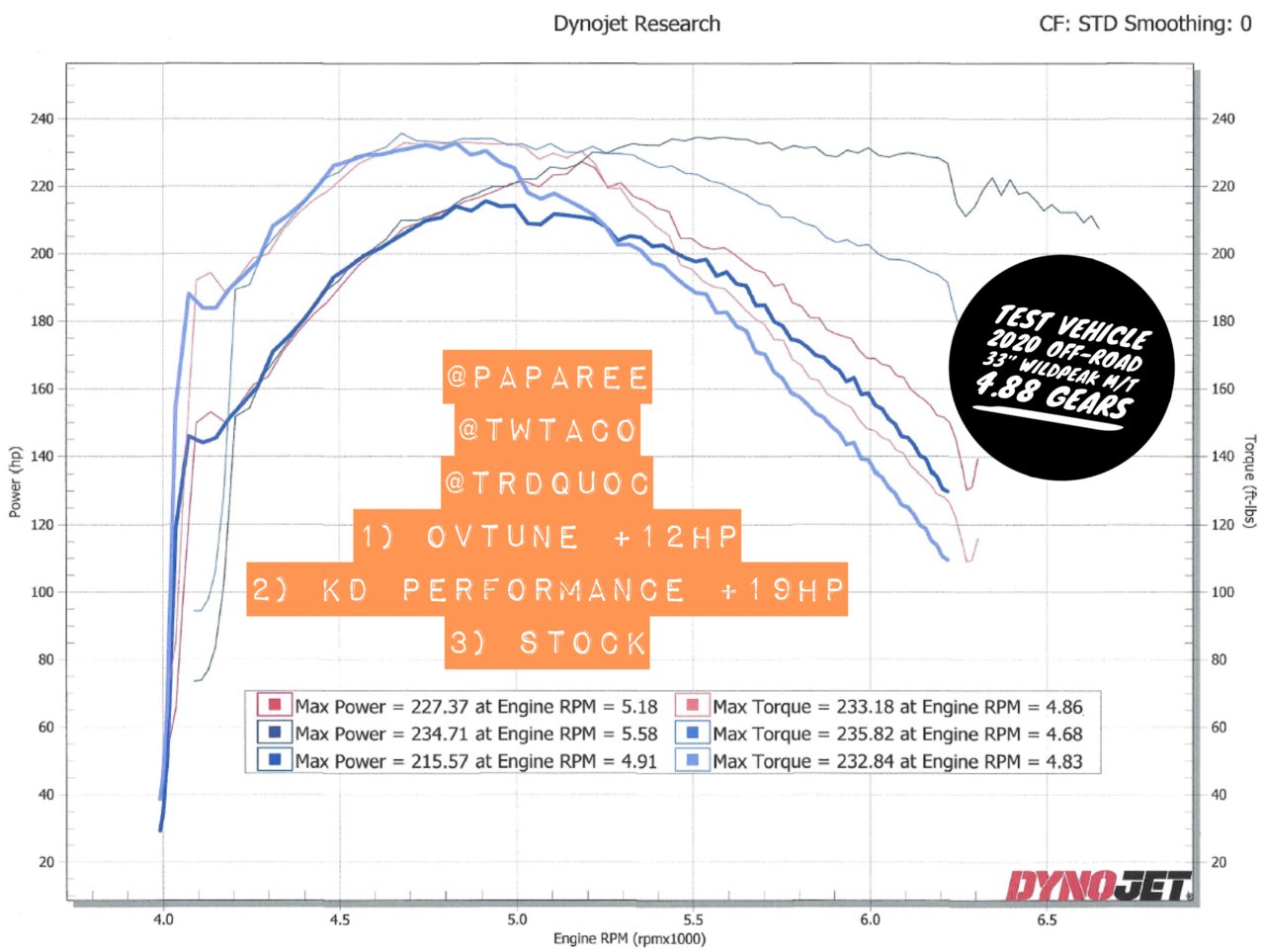

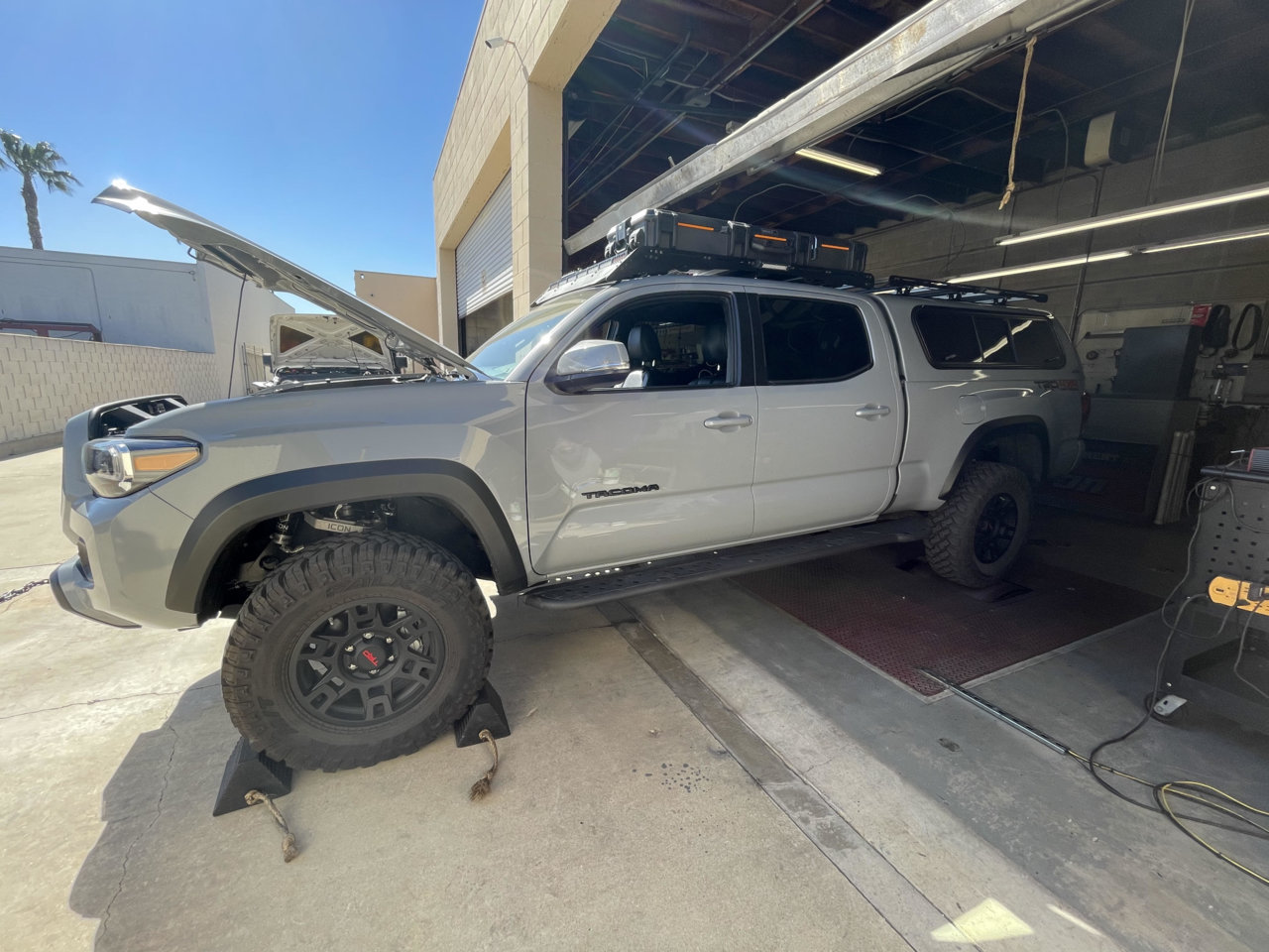

    Boys and girls... I went to the Dyno today just to test out @PapaRee 's KD Performance Tune on the rollers... just to see what a loaded down truck could do, we ran 3 pulls and yes the graphs are only top end numbers, but it was very difficult to get a baseline test with the stock ECU flash because all it wanted to do was shift up. So we decided to pin Stock vs. OVTune 2.0 vs. KD Performance to see what the top end numbers were. Just to show you some real world numbers, with a real world truck. I wish we could have had some better low end numbers to show, but anyone who drives this PROVEN and TESTED tune knows that Paparee has done some excellent work.
    We would imagine that a STOCK truck would have better performance numbers due to the rotating mass of the tires are a lot less... but I wanted to test this the way it was for the average geared Taco.
    EDIT: The truck had 91 octane, but the tunes we tested were the 87 octane tunes.
    Let us know if we can help! @PapaRee @TWTaco @trdquoc
    Truck: 2020 Off Road, 33" Mud Terrains, 4.88 Nitro Gear
    Stock: 215HP / 232 TQ
    OVTune 2.0: 227HP / 233 TQ
    KD Performance: 234HP / 235 TQ

    awesome! We have almost identical setups (except 32’s and softopper) and this is good news. His premium Kruiser 4.0 with the slightly less tip-in is cherry and a pleasure to drive. I could tell the difference just in the tune coming from all the tunes since 2017. Nice work
    btw, this chart is going to be impossible for color blind dudes to read. They could have chosen an orange or green besides all blues and reds...oh well

    Hells yeah. Check out that 5500rpm delta though!
    I have my pull rescheduled to next week. I’ll find the low RPM figures. My truck is stock except for my CAI and catback. It will be nice to see all of the differences. I’m still speculating ~15-20hp/tq difference.
