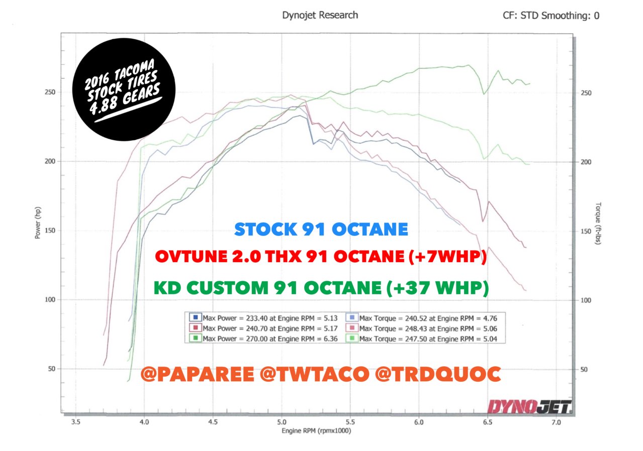

    Well today we went back to the rollers with @TWTaco ‘s truck using @PapaRee ‘s KD Performance tune. Last time we used my truck using 33” M/T’s and while the performance numbers were good... using stock tires was great!
    Stock and OVTune 2.0 seemed to have the power dip at about 5300 RPM, and KD Performance has a pretty linear power curve all the way up to the 6300 RPM fuel cut that’s built into Toyota’s software.
    All tunes were using the premium 91+ octane maps!
    Stock put down 233 WHP
    OVTune 2.0 w/THX 240 WHP
    KD Performance 270 WHP +37 Over Stock!

    Well, we knew on stock tires the numbers would be better. They are!
    Even the 2.0 gained hp on stock tires.

    need a 87 octane dyno for us cheap asses :D
    edit - why only 4K rpm +
    Are you not able to start the dyno at ~2500rpm ?!

    We were not able to Gearlock the lower gears (even with gearlock activated), the truck will still shift. One thing about Toyota software, it has a lot of safety features, it looks at many variables and will eventually shift if you don't.
