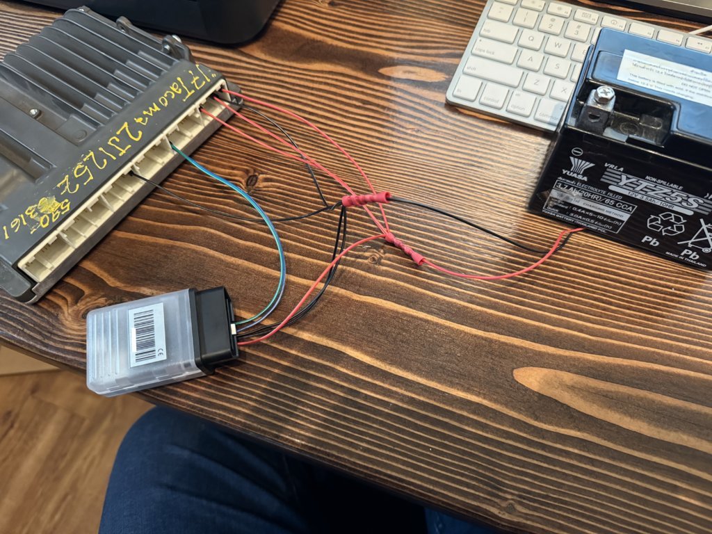

    I had to do that too back when I bricked mine (send the seed). Although I thought they unlocked the recovery utility for everybody...guess they locked it down once again.
    Recovery never worked on my ECU. I went to a junk yard and got a new ECU for $175 and flashed my VIN to it. A few days later I got the stuff needed to do the bench recovery and was able to successfully recover my OG ECU, which I now have tucked away for a rainy day..lol.

    @Technique Awesome info. How hard is it to do the bench recovery? I don't mind if that's what it comes down to to perform.
    how do you flash your vin to another ecu? Techstream? Curious on that process.
    also what was recovery flash behavior? Would it flash about 10-20% then error out like I'm having?

    It's not that hard at all to do, really. It does seem kinda scary at first. A battery + some cables (like 10$ on Amazon) to connect the ecu to the dongle and plug it into your PC.
    Yes, you use Techstream to flash the VIN.

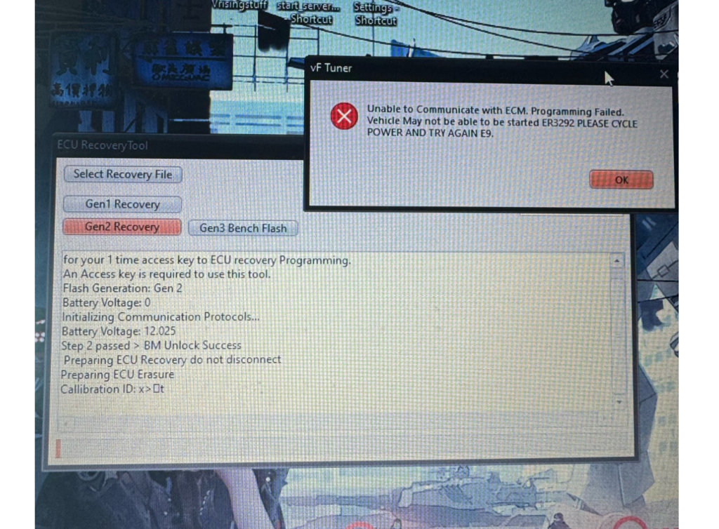

    interesting, mine starts to flash and makes it random % through flashing then errors out, at which time i also get the sound of the usb device disconnecting and reconnecting on windows. which makes me think maybe its something weird going on with my usb extension cable. even though i've used it in the past to flash several times.

    Yes, I have access to recoery, when I run the gen2 flash in recovery and flash the stock 04b33 file, it gets about 20% of the way through and i get the sound of the usb device disconnecting and reconnecting and get this er message ER1632. if I try recovery with a different tune file it makes it only about 5% through and same error.

    Well, Good news! got the new USB cable today delivered and the flash went through no problems at all. Had a feeling maybe the USB extension cable was messing up. Used it many times in the past, maybe it just finally got bent or something weird. Who knows but i'm stoked to have the truck back up and running. Recovered to the stock 04b33 file, then flashed my Yotawerx file right away both went through no problems! Thank you all for your help, whew that feels better.
