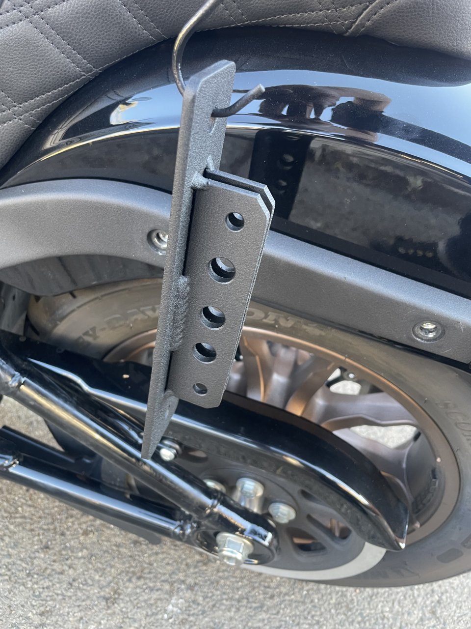

    Time between coats isn’t much honestly. If you use the heat gun method, you can pretty much hit the part again once you have even texture- that means the surface is dry to the touch. You don’t have to worry about delamination or getting solvent-pop fish eyes the same way you would with regular paint because the way this coating was designed, the surface dries before the underlying layers of paint (that’s what causes the wrinkles). I’ve painted my Iggy switch panel as well as parts on my bike with it and they’ve been holding up for several years now.

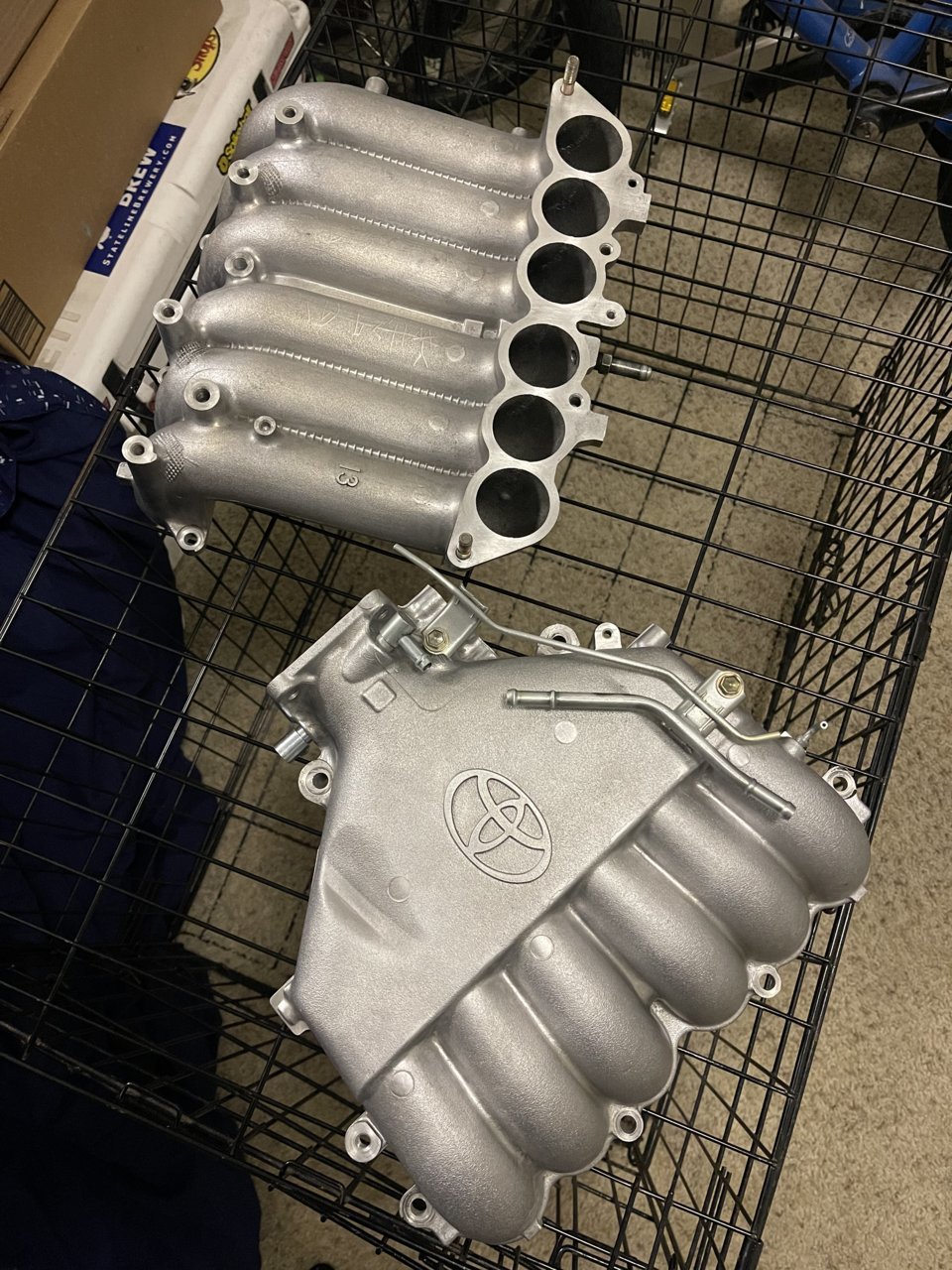

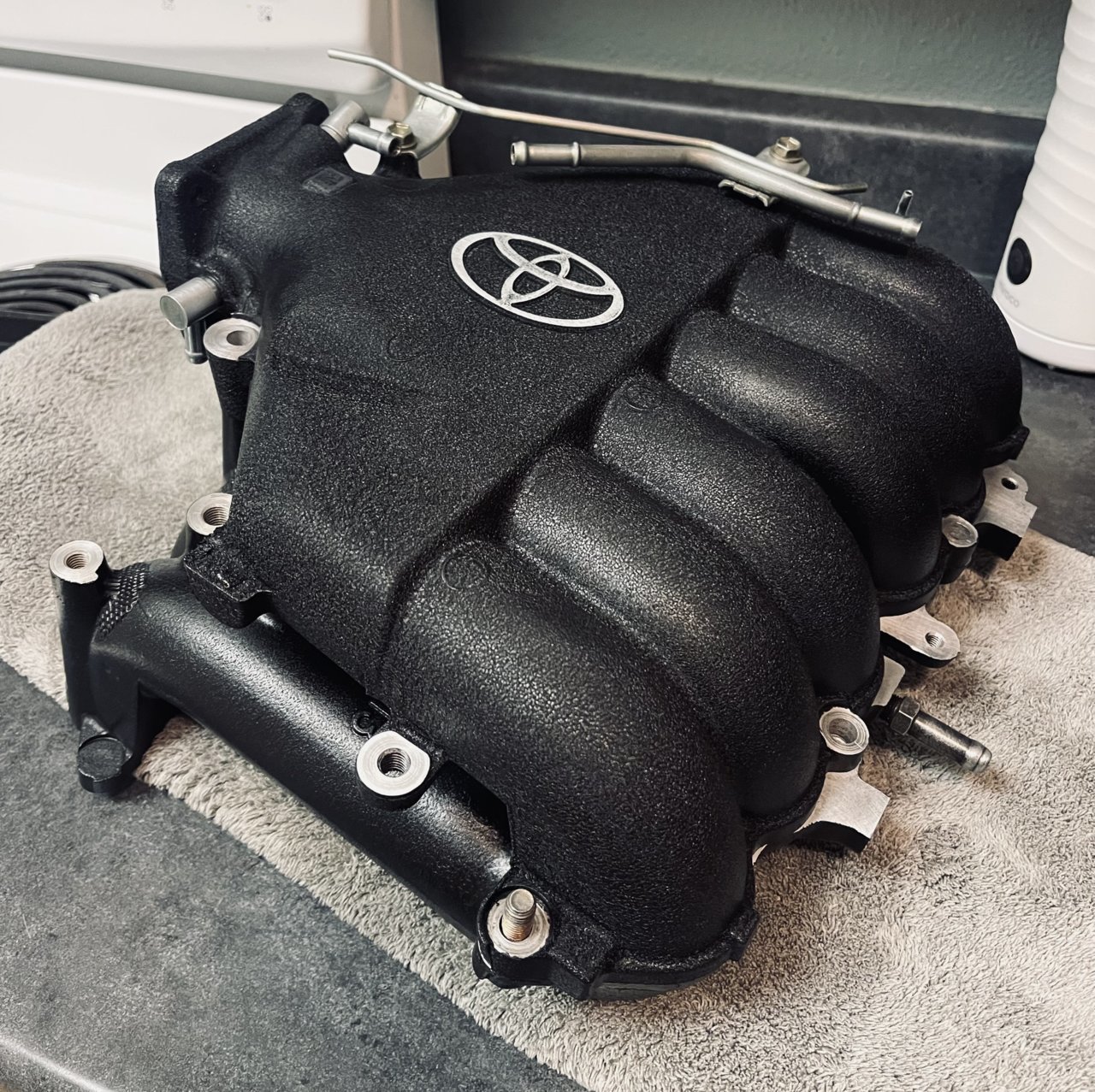

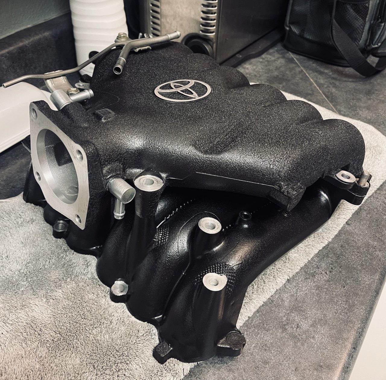

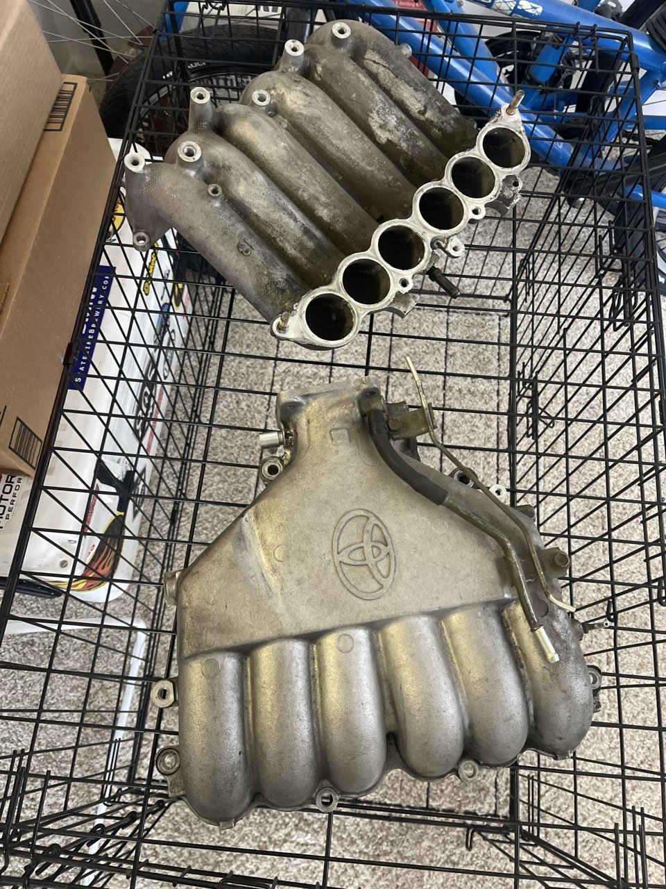

    Pics of before and after prep then paint.
    First attempt with the upper plenum. Wasn’t thrilled with the original end result so I threw on another layer the next day which seemed to even things out a little better. I think I went a little too heavy on the coats in a few areas. Heat gun and eventually baked it at 200 for 20 minutes.
    I almost considered not painting it at all and just leaving it super clean in the second pic but I had already bought everything for this job and was pretty set on experimenting with this stuff. Plus I think the black wrinkle would look sick like some old school muscle car lolol.
    I plan on sanding down the Toyota emblem soon and doing the lower plenum. I’ll post some install pics eventually.
