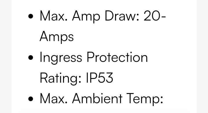

    Screenshot_20241127_085728_Brave.jpg I'd be more concerned about WHY you're popping fuses more than carrying spares.
    The 88p is a 20 amp max draw.

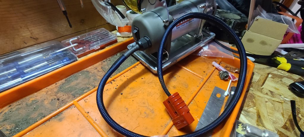

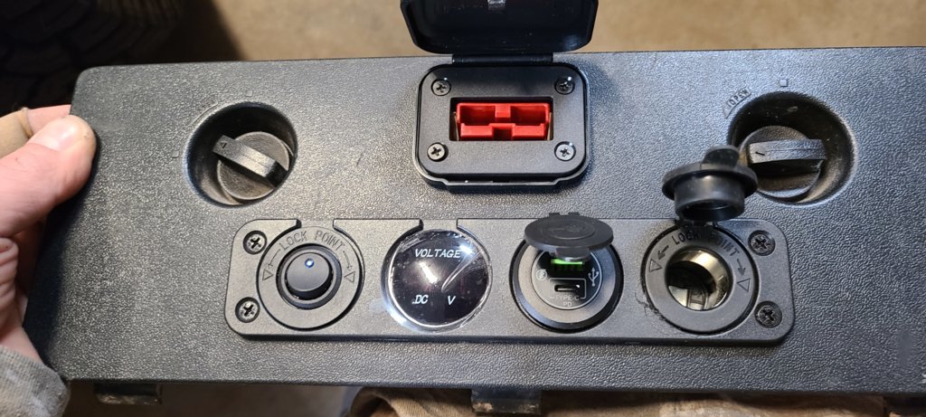

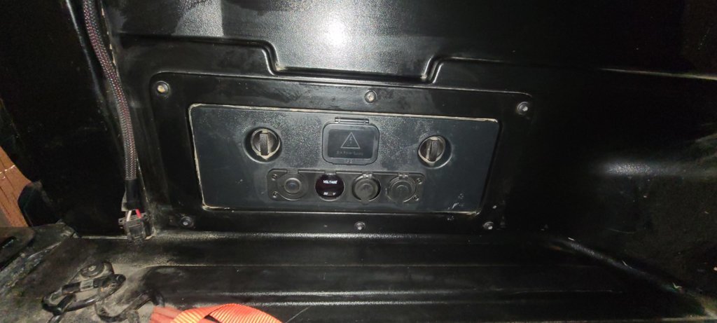

    I have the 300p that I rewired with 8ga. wire, hoping that having the voltage needed, available will allow it to run more efficiently and cooler.
    I ran a 4ga. wire back to the driver side cubby and inatalled a 50amp Anderson plug with a 30 amp inline fuse and another 100amp on the 4 ga. line.

    All my shit is in the bed. I didn't want to unnecessarily open the hood. lol

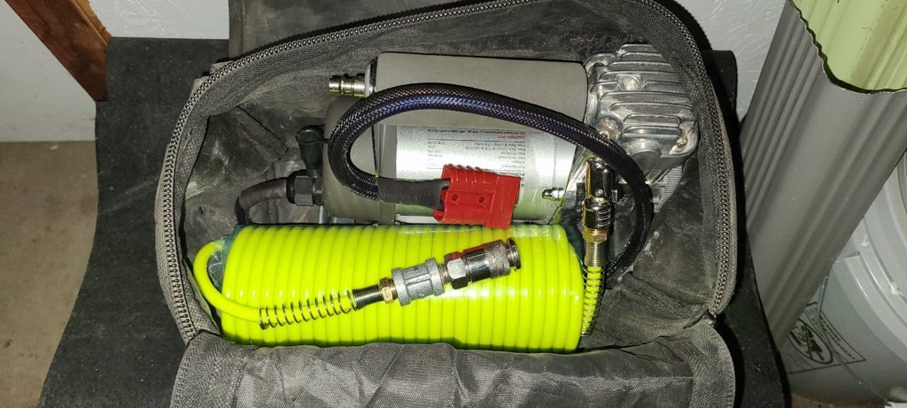

    A lot of times I end my trip with a trail run back out, so all my gear is packed in tight for the road. I’ll air up when I hit pavement.
    Putting it away in case fitted to the bedside wall then would be terribly inconvenient.
    To be honest, I let that thing hang out “somewhere” “non-flammable” in the bed until I get home.
