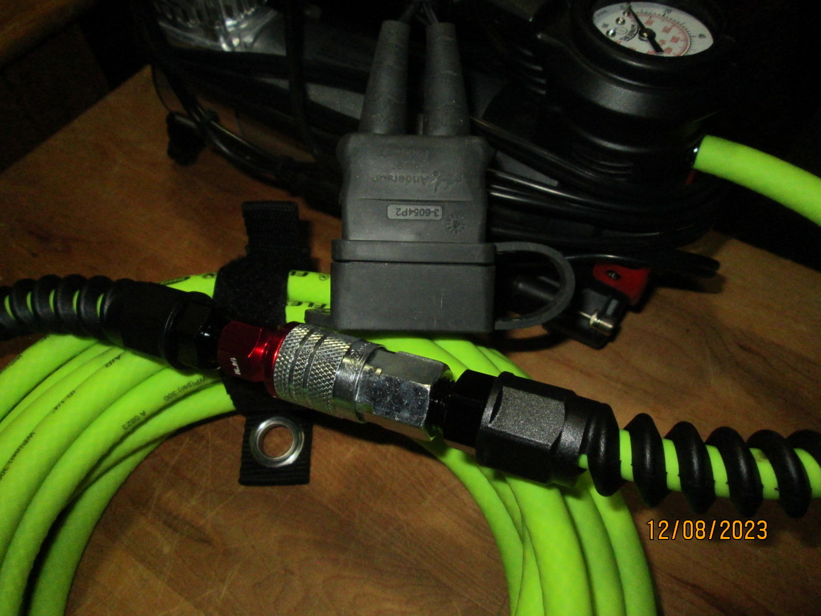

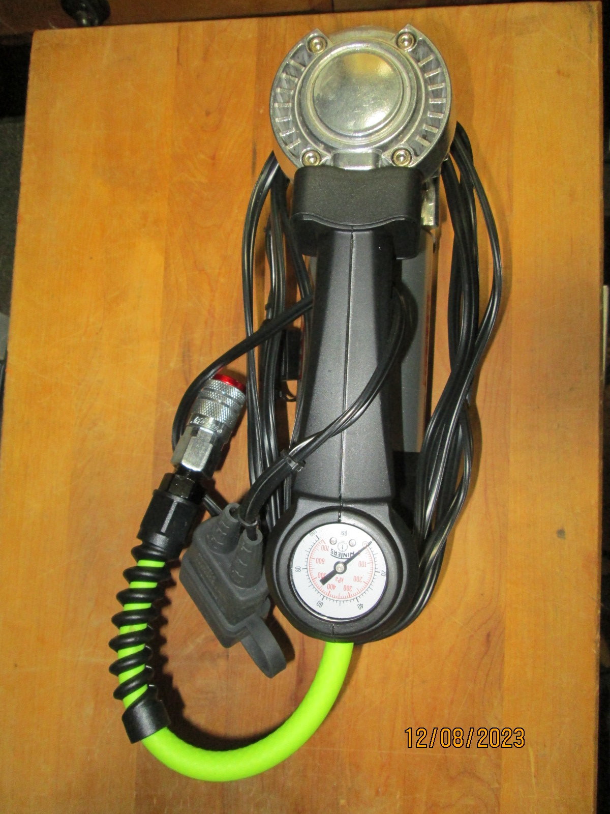

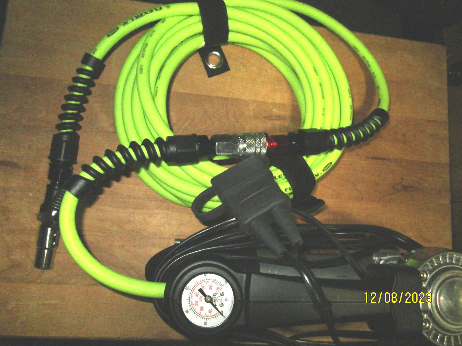

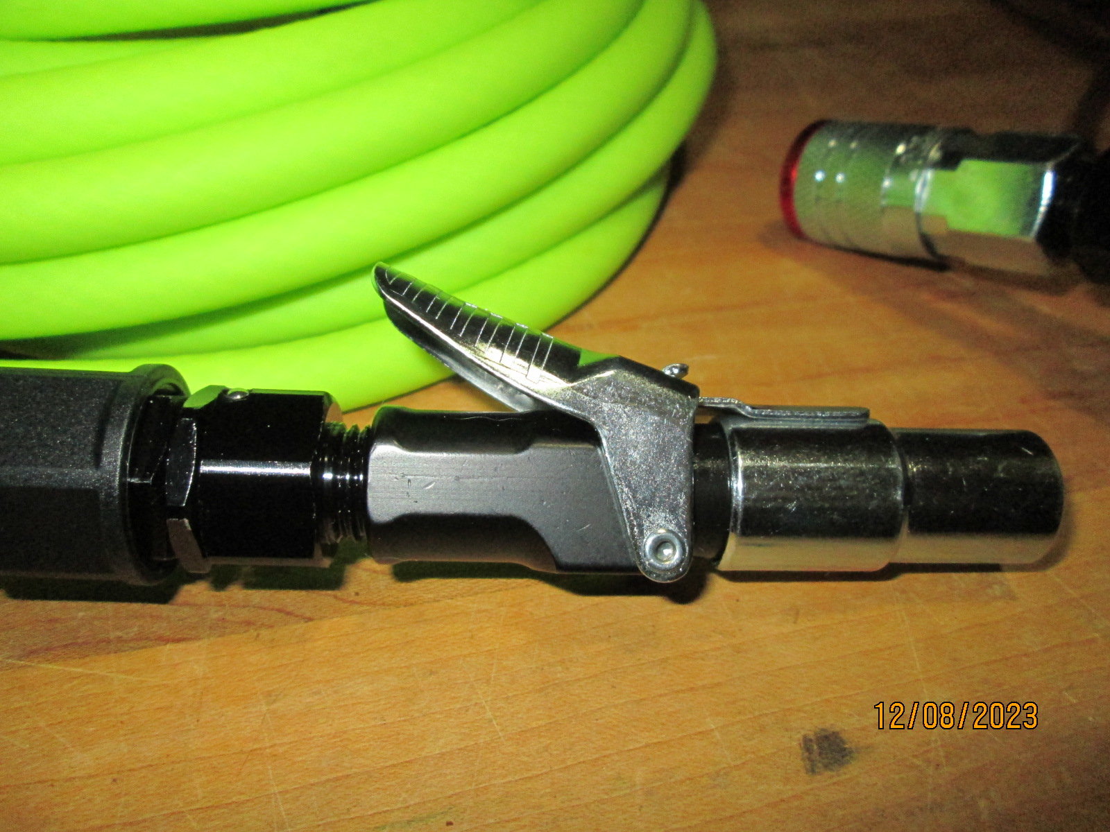

    I was inspired by Gutentight thread several years ago I decided to dive into doing some mods to my Viair 88P. That thread can be seen here https://www.tacomaworld.com/threads/viair-88p-hose-upgrade.693695/
    I did the hose swap as outlined in the above thread. It's pretty easy if you take your time as not to damage anything. I used a quick disconnect by the compressor to make stowing the compressor a little more convenient. The hose & compressor can be stored in different locations.

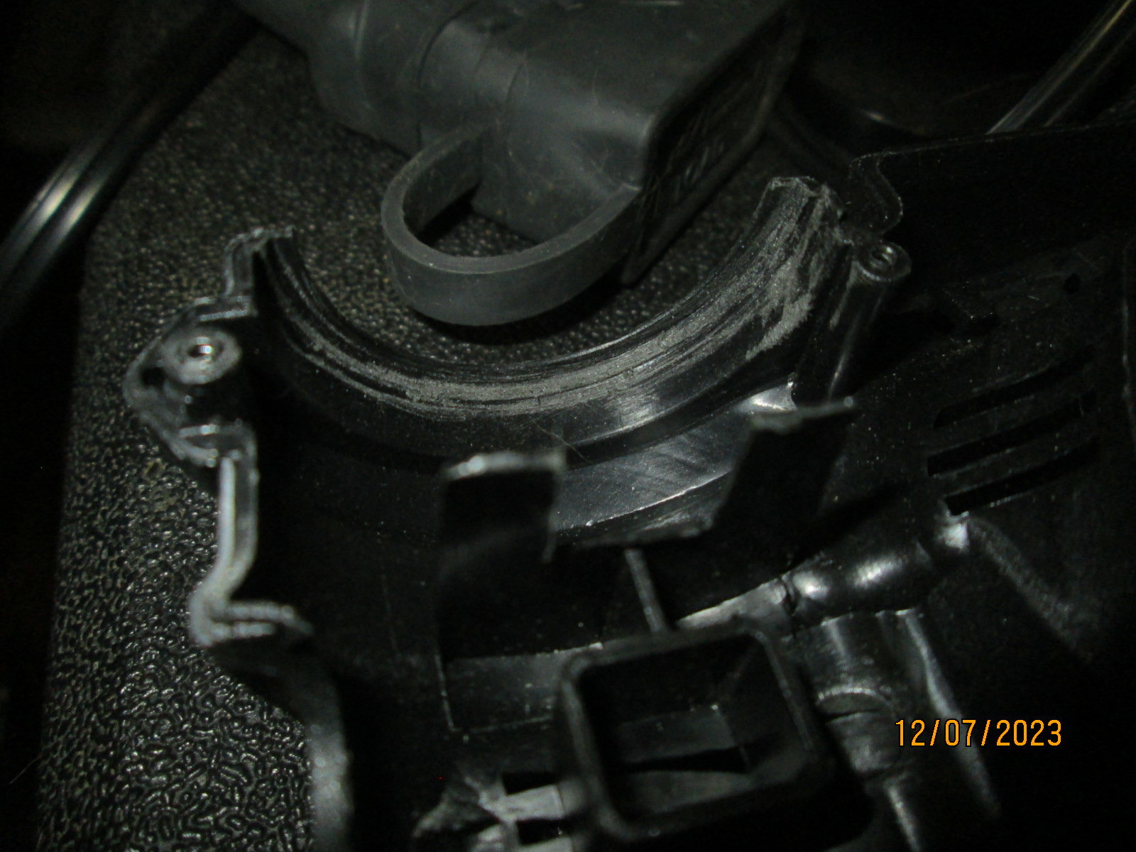

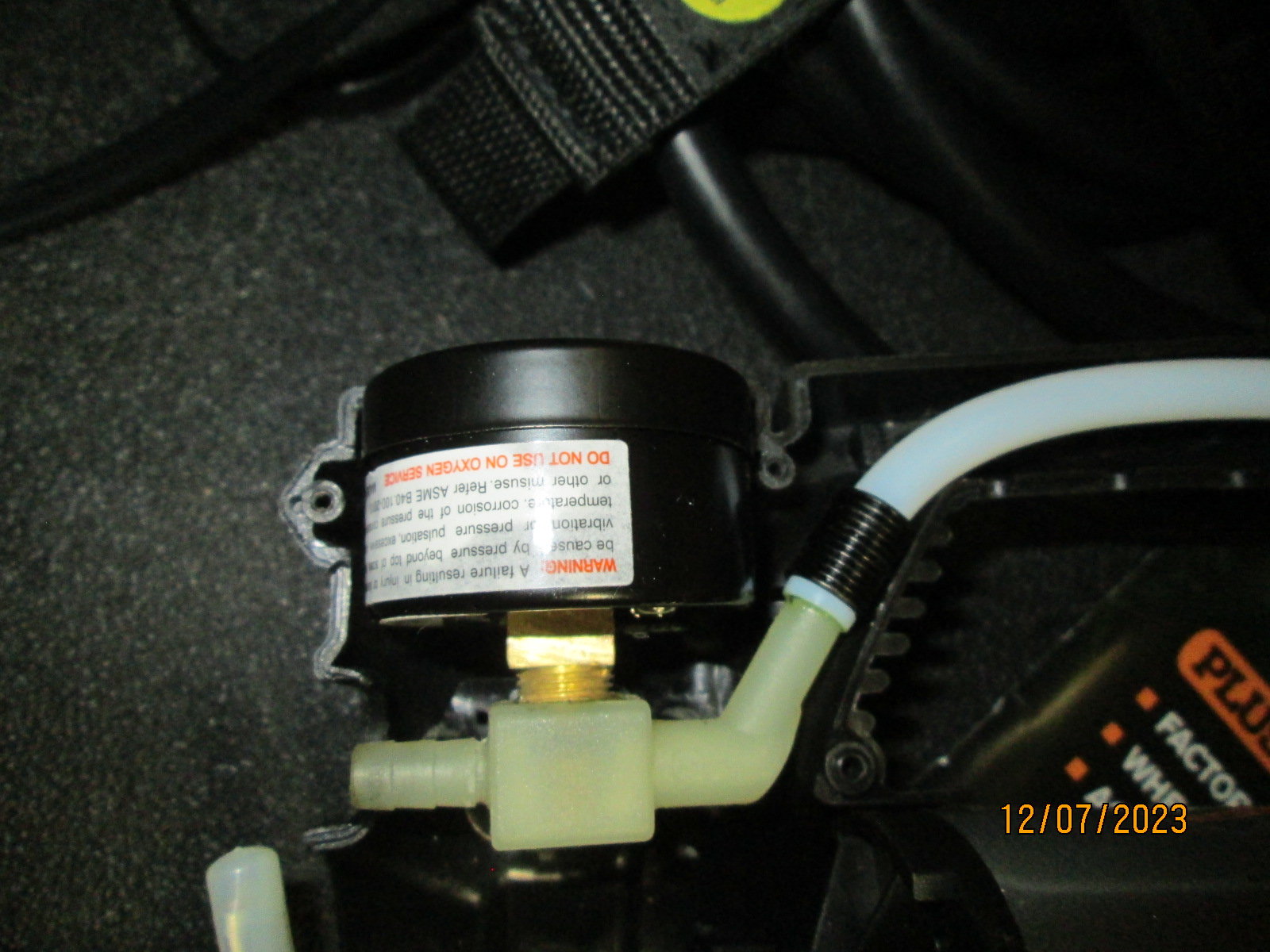

    I installed a Winter's 1 1/2" pressure gauge because the original one was inaccurate. This required minor massaging of the plastic compressor cover to allow the gauge to "seat" and the compressor cover to close together. I used a riffler file but a dremel would work and be easier & faster. The gauge is 1/8" NPT.

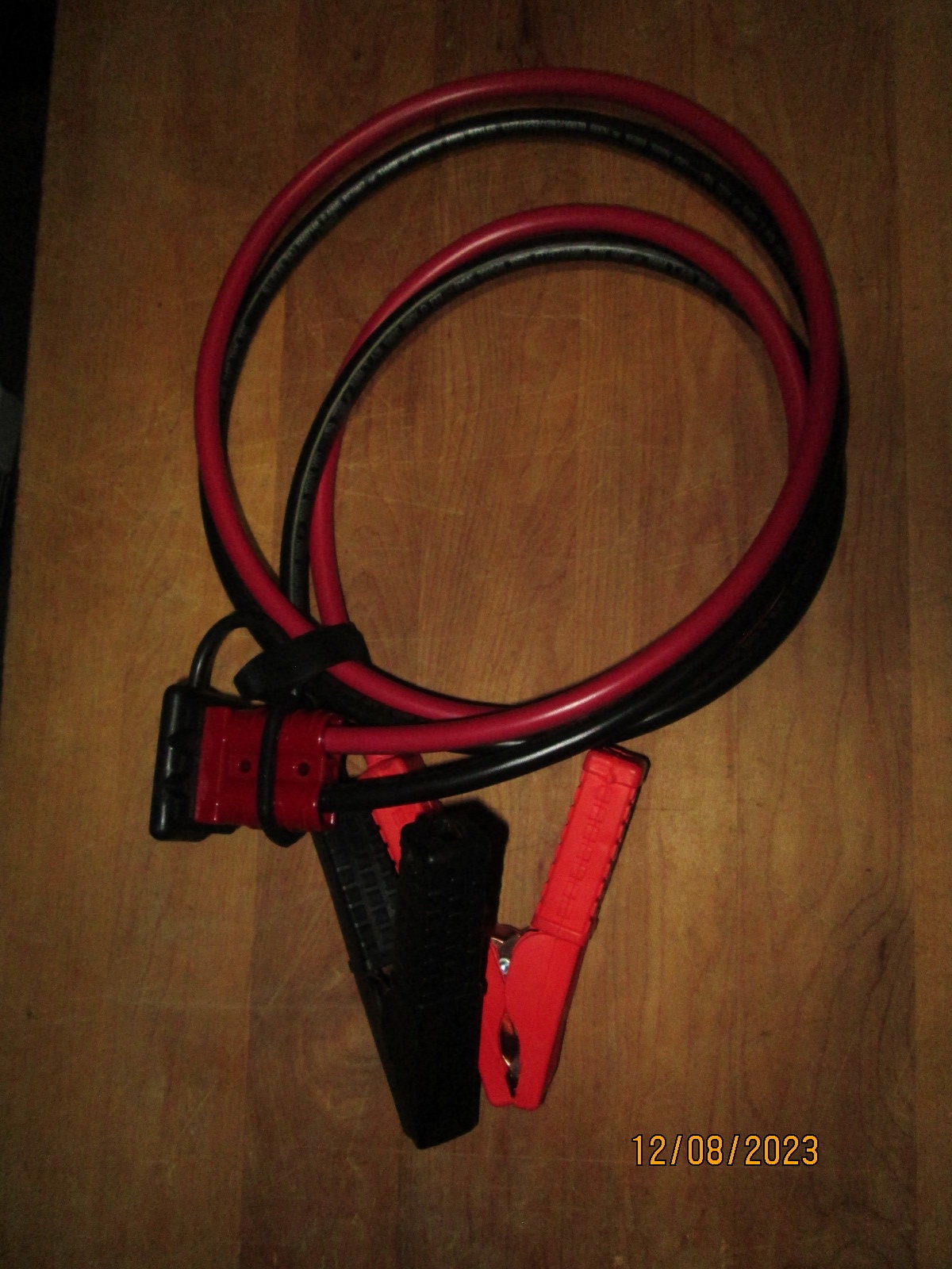

    I swapped out the battery clips in favor of a Anderson connector (SB50). I ran 10 gauge wire from the battery, along the firewall to the passenger side with another SB50 connector.This connector is far better than the battery clips and I think they are safer. Going this route I have effectively made the compressor dedicated to my Tacoma. I had another Anderson connector with wire and HD clamps made to use in the event I need to use the compressor with my wife's RAV4.

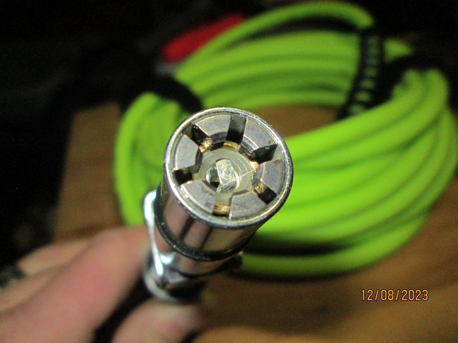

    Finally, I used a Lock-N-Flate air chuck. I believe they are the best on the market featuring 6 jaws instead of the usual one or two jaws which are notorious for leaking. These pretty much put an end to that. They are pricey but worth it.

    Oops!I forgot to include the battery clamp cable photo....

    Is that picture ^ showing factory internal plumbing with your aftermarket gauge? It looks like plastic hose and fitting?
    Not a dig against the 88P, I used mine for almost 4 years before finally installing and plumbing my ARB single. Im just shocked the plastic can handle the heat cycles

    Yes. I didn't change anything internal other than the gauge. Apparently the type of plastic used can take the heat cycles. I don't know what type of plastic it is but it is flexible to a degree. Maybe some type of nylon?
