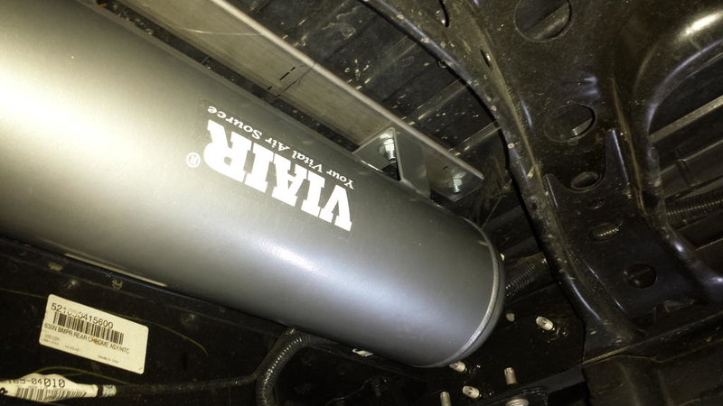

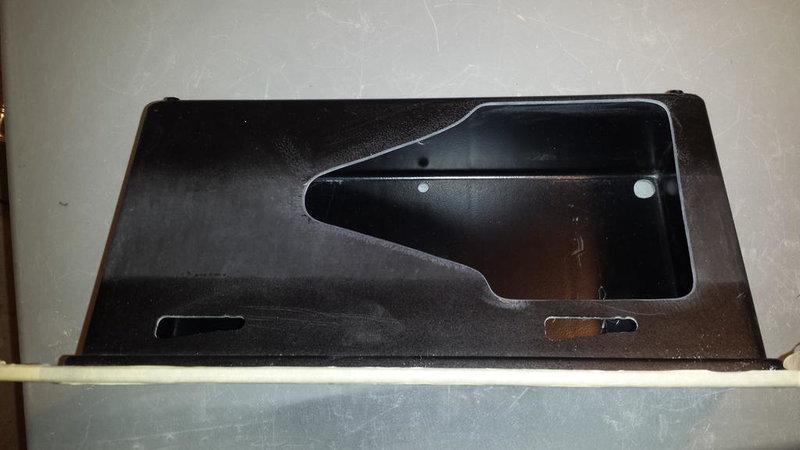

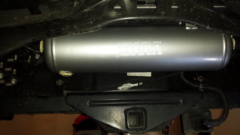

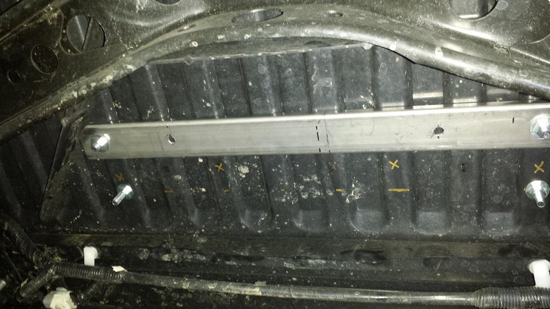

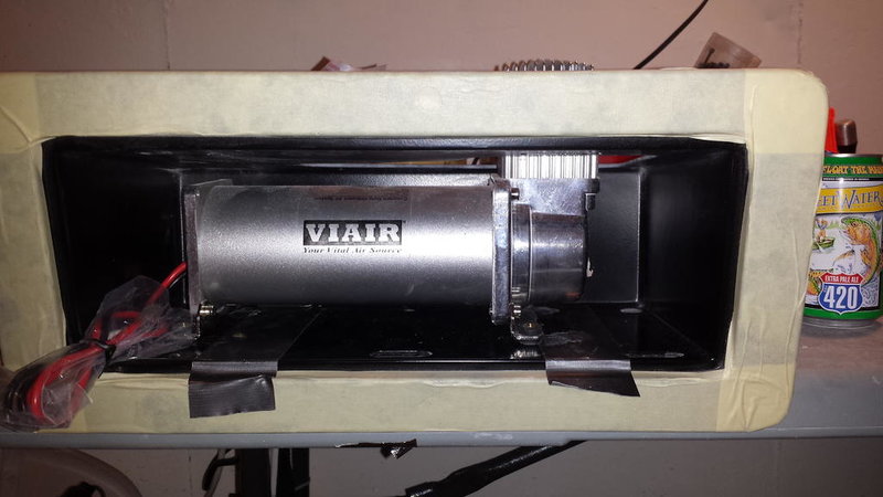

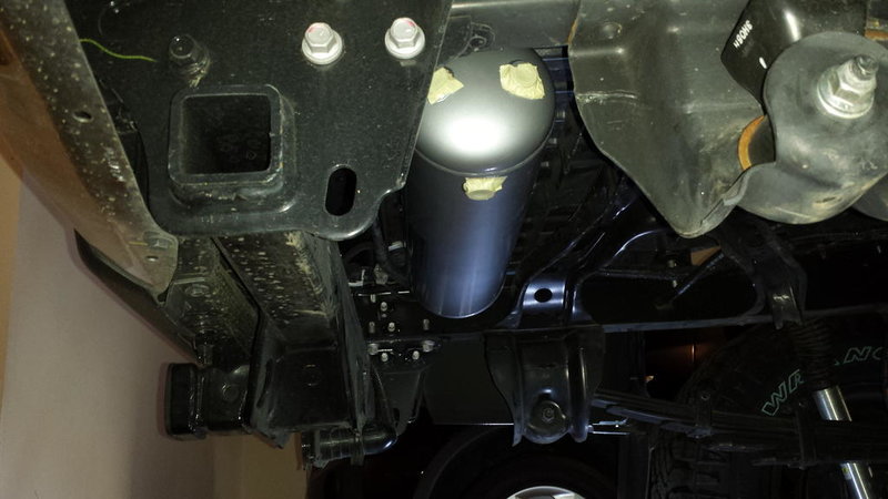

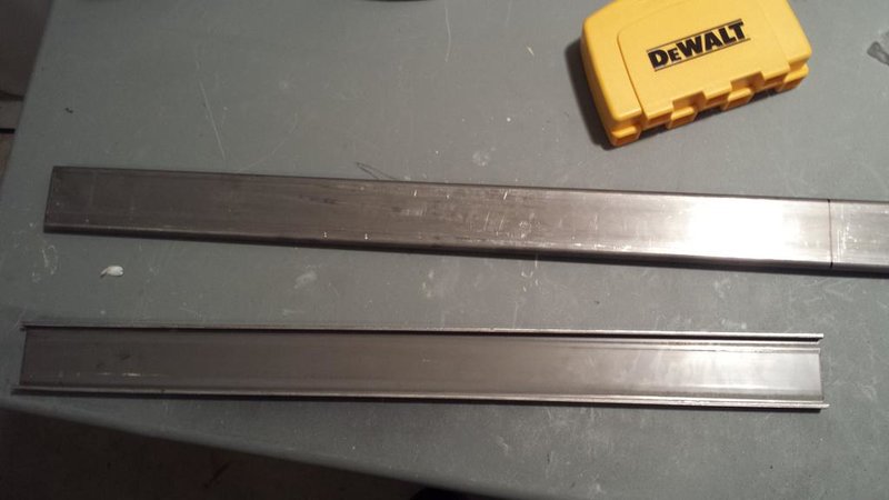

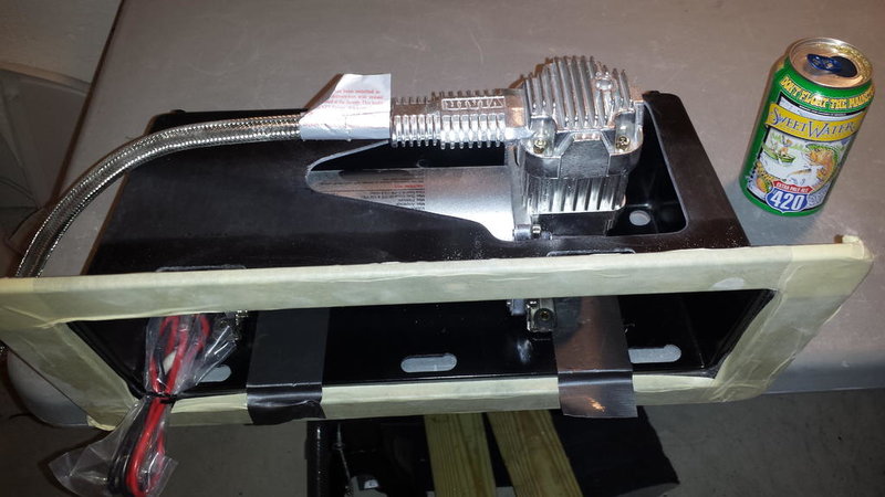

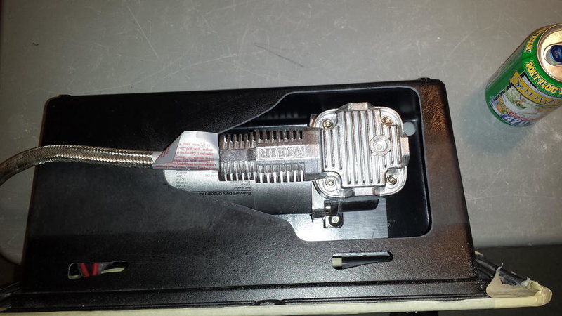

    More pics coming soon. The install is coming along pretty well. Fabbed up some new parts, mocked up the system, and painted the mounting rails. I chose VIAIR after a friend recommended them since the compressor doesn't have to run all the time with the pressure switch and storage tank. He has an ARB compressor, and whenever he runs his lockers, the compressor runs the entire time. Also for a 2.5 Gallon VIAIR tank it's only about $65. for a 1 Gallon ARB tank it's $150.

    On the other hand, the ARB tank is aluminum, which is obviously lighter and corrosion resistant. But Steel tanks will last a LONG time. I plan on putting on some 3M protective coating "tape" to protect it from any paint damage.
