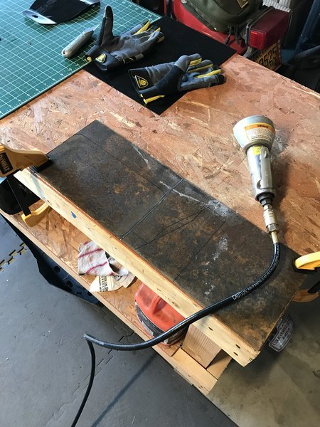

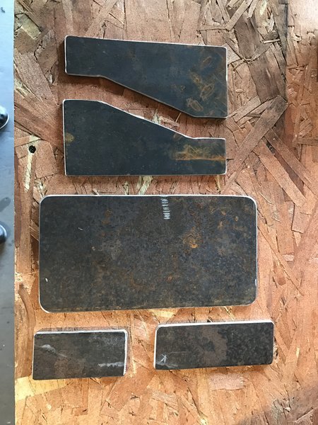

    Plate steel: 3/16 in
    Working with limited tools, grinder with a cutoff wheel did the trick and only caught my coat on fire once.

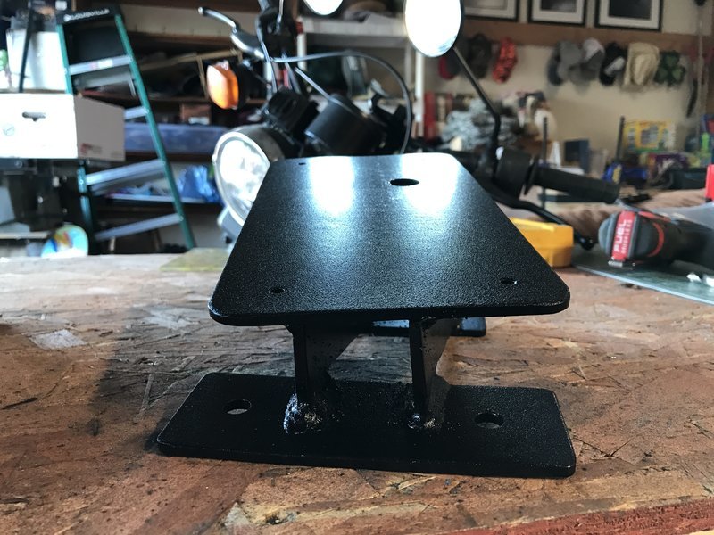

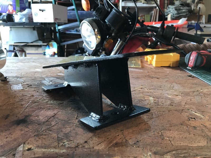

    Finished product. Sanded excess rust, welded it up, rustolium paint and a top coat of spray on bed liner.

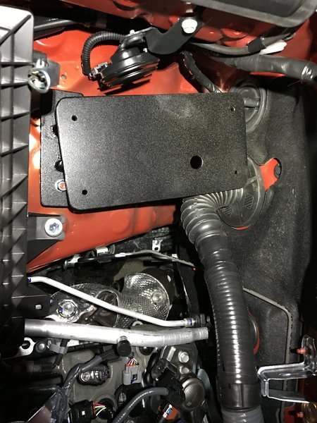

    Installed base in front of passenger side, under the hood. Used the three screws sticking up there as contact points.
    Hole in the top plate is to access the lower bolt.

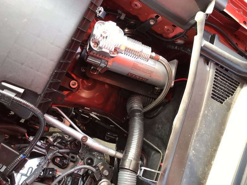

    Installed compressor.
    There's about 1/2 in space between it and the air intake so hopefully it doesn't get too hot!
    The air filter is inside the air filter box (hole drilled, intake line incerted).

    Question: what is the point/benefit of an air tank if you already have a compressor? Air tools?
    Mikey-C[OP] likes this.

    From what I understand, having the tank gives you a bit more to work with (like power tools) and also helps air up that first tire or two a little faster I guess.
    I haven't used one yet but it came with the Viair kit I bought so if I can fit it, I'll bolt it on too!
    And what ^ said...

    Went with the constant duty cycle P/N 10007 for up to 37's. I won't do much bigger than 32's so I should air up pretty quick from the 10-15 I like to go down to in the snow/sand.

    Yeah, I'm sure it would fit in that spot also. The mount I made was about 1 3/4 inches higher than it needed to be so there's plenty of room in that spot.

    Your design could also work with aluminum no?
    Unfortunately I have no welder.
    Are you considering selling some these or sharing the dimensions?
    I would buy one for the right price.

    It would definitely work with aluminum as well but I'm not as good welding with aluminum as I am steel.
    I thought about a price point when I was making it on time/value to me etc.... Not sure, what's it worth to you? It's about 3hrs of work and $20 of material.
