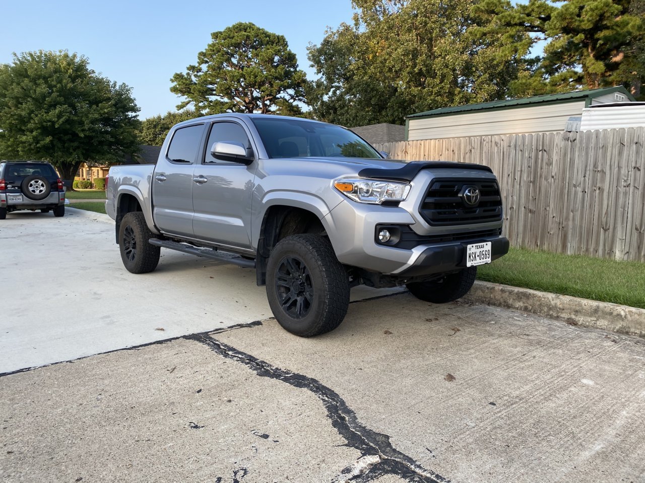

    3/2 RC lift. ECGS bushing swap. 1” diff drop. OME carrier drop. Still trying to get rid of the damn 2WD-only pulse vibe.
    21668263-5B54-4386-AD4C-8D8ED6E27C41.jpg OK, gents, what do I do next? A month ago, I put a 3”/2” Rough Country lift on my ‘19 SR (https://www.roughcountry.com/toyota-suspension-lift-kit-745c.html?find=2019-toyota-tacoma-4wd-740124). Yeah, I know, sorry it’s not some kinda badass high-end job, but I got kids to feed and this is what I had to work with.
    Naturally, I immediately got the much-discussed post-lift vibration. Sort of a slow, cyclical vibration/hum you can feel more than hear, through the steering wheel and a little in the gas pedal. Perceptible from 43mph to about 53mph, but peaks at 48mph, when you can hear it most. The vibe/hum disappears when you drop it into 4HI, but comes right back when you put it back in 2WD.
    Followed the universal advice and swapped the OEM needle bearing on the driver’s side for the ECGS bushing. Same exact 2WD-only vibe—didn’t change it a lick.
    Removed the front differential drop spacers that came with the kit, today, thinking maybe the CV angle change would clear it up. (Don’t worry, I’ll do the boot mod too) Same damn vibe. Didn’t even change the pitch, or speed, or anything—same exact 2WD-only vibe.
    I even rotated the tires again (which were rotated when it was lifted only a month ago) to see if it was just tire cupping or some crap like that. Seemed like a long-shot, since the vibe depends on the front diff not being engaged, but figured what the he’ll. Same F’ing vibe.
    What now?
