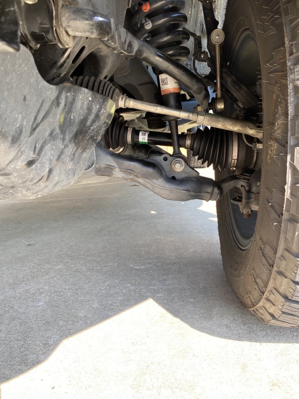

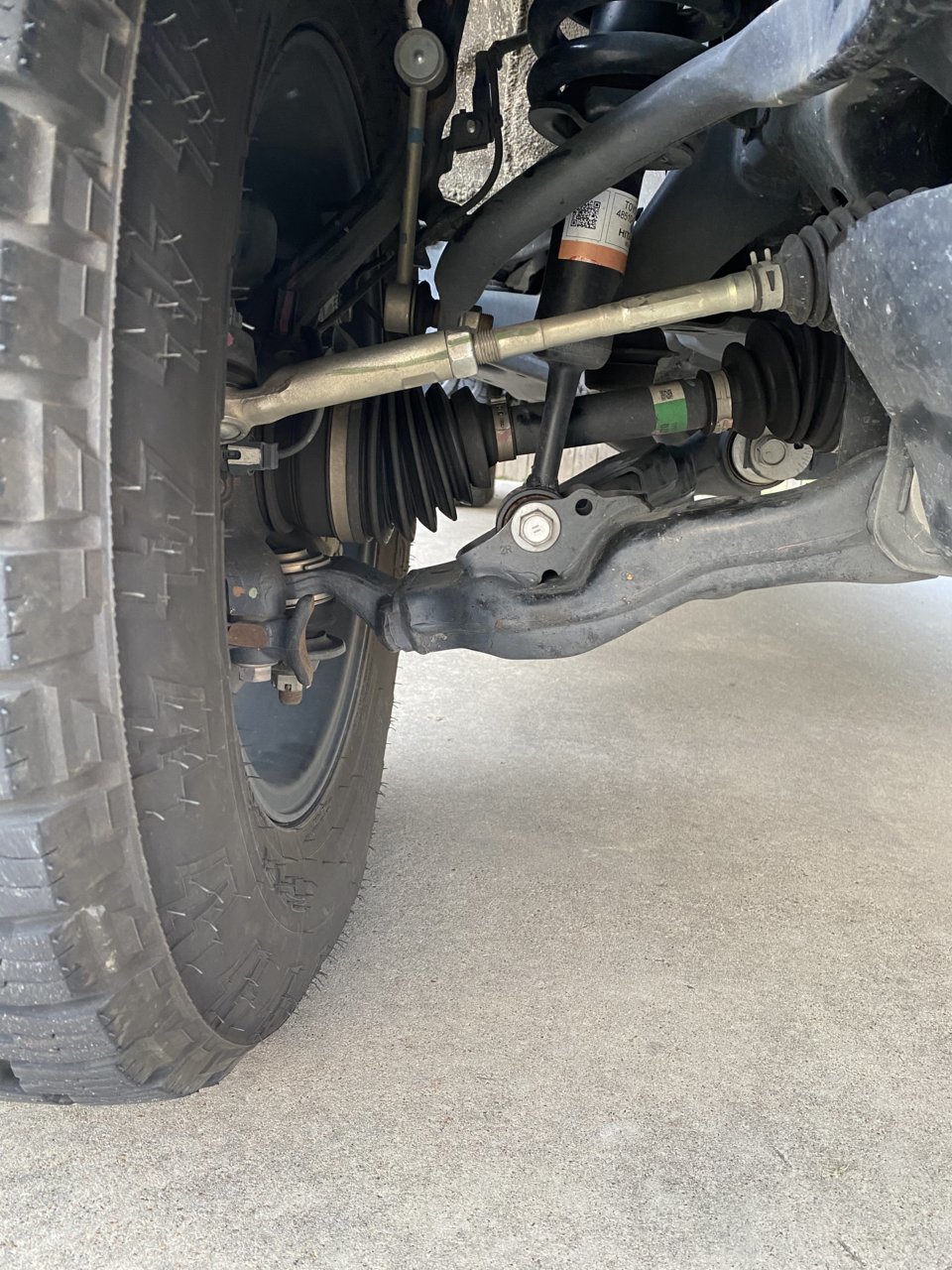

    37
    2019 SR 4x4 V6
    3/2 RC lift. ECGS bushing swap. 1” diff drop. OME carrier drop. Still trying to get rid of the damn 2WD-only pulse vibe.
    Welp, the carrier bearing drop didn’t help. Neither did the 1” diff drop I put on this morning. Same 2WD-only pulse vibe that peaks at 48 mph. CV angles look better with the 1” diff drop than with the 1/2” diff drop that came with the RC kit (pics below), but still the same old pulse vibe that disappears in 4HI.
    Gonna swap the front tires across, to eliminate the freak chance that will work. And then maybe have them road-force balanced for the hell of it, if it doesn’t.
    Anybody think a wheel bearing on its way out could quit making noise with torque put on the CV’s (ie with 4HI engaged?).
    Maybe a CV joint gone bad cause it just didn’t do well with the lift?
    Any other ideas?
    Driver’s side CV before 1”diff drop:
    Driver’s side CV after 1” diff drop
  8. Oct 10, 2020 at 10:18 AM
    #48
    Traction
    Traction Well-Known Member
    May 23, 2016
    #187673
    1,321
    WA
    2020 TRDOR
    Are you only perceiving the vibration as coming from the drivers side?

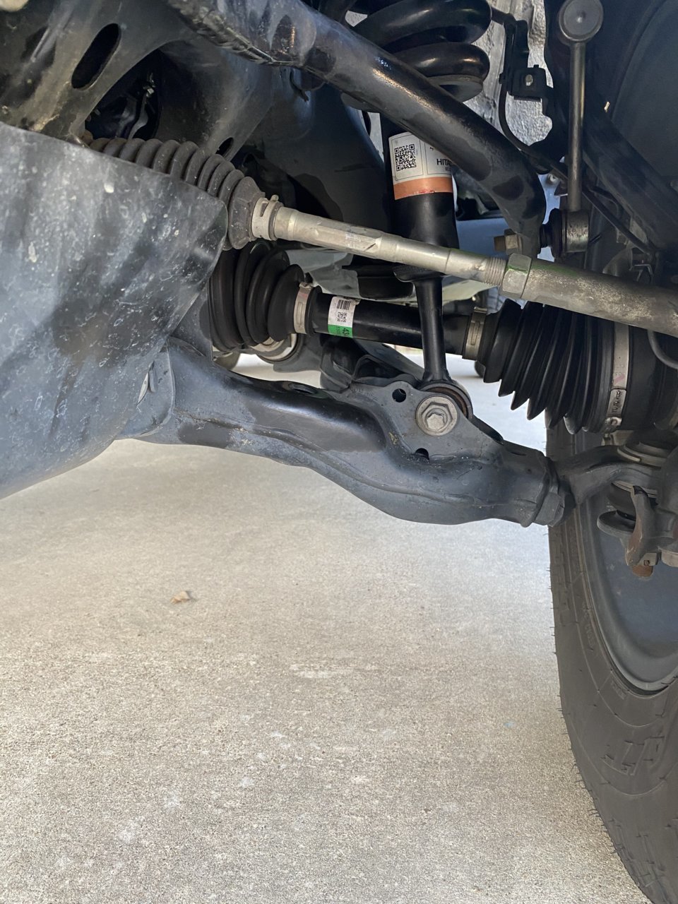

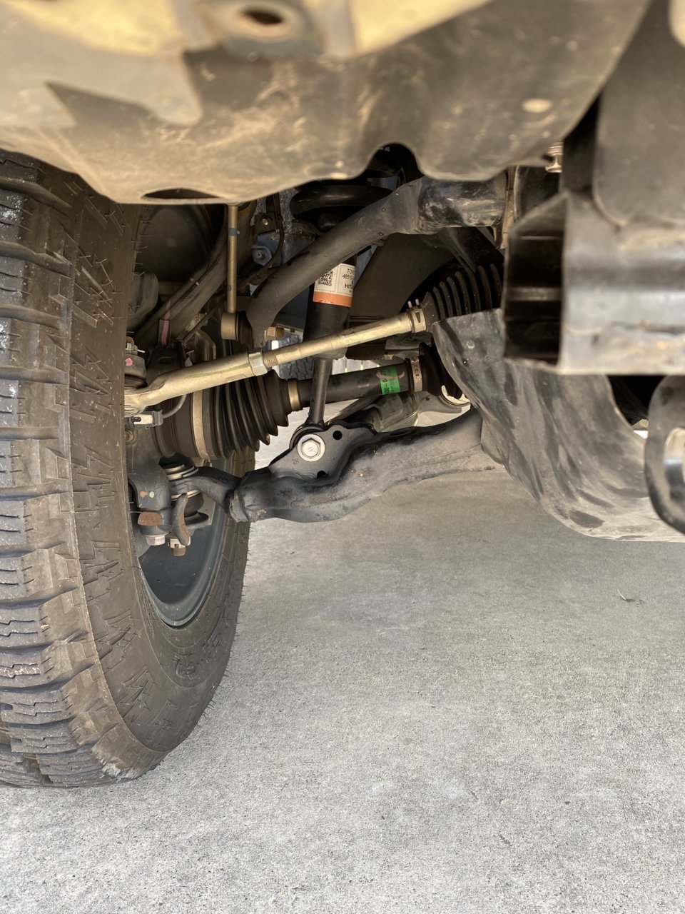

  10. Oct 10, 2020 at 10:43 AM
    #50
    Ataconamedsylvia
    Ataconamedsylvia [OP] Active Member
    Aug 30, 2020
    #339228
    37
    2019 SR 4x4 V6
    Passenger CV before 1” drop:
    Passenger CV after 1” drop:

    That bushing has to be installed incorrectly, what you’re describing are the exact symptoms. Your rear driveline is not affecting your front, a big benefit of ifs is that you never need to mess with your front driveshaft or pinion angle.
    if you feel it in the front it’s gotta be the culprit
