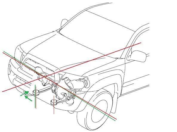

    I had pretty good luck with a specific vibe. I wanted to try a Diff Drop thinking it might help with a vibe that had been slowy increasing in intensity over the past 6 months. I had the diff drop kit laying around so I thought I'd try it out. Bad idea. I caused a brand new and rather intense 10-15 and 40-45mph vibe as soon as I installed it. The weird thing is the vibe remained just as intense even after I removed it. I was surprised because I expected that removing the diff drop and returning it back to the way it was would take me back to my relatively vibe free condition. I was really unhappy :mad: to put it nicely because that didn't happen, it was absolutely miserable to drive at certain speeds.
    So I thought about it and deduced that when I broke the front diff mounting bolts loose and installed the drop spacers, I caused a small shift in the front diff position and had not returned it to exaclty where it was positioned originally or I had not acheived the same torque level from the factory installation, or a little of both. There's a small amount of play with the 2 main mounting bolts and brackets and I used a 2 foot breaker bar to break the bolts loose originally, and they were really tight, so I think this is plausible.
    Anyway, I seemed to get it back to where it was with some trial and error, or maybe I just got lucky, IDK. :) I really can't know for certain because I made no measurements but the pic shows how I tried to pry it a little and I did push those bolts a little past spec, to at least 110FT/LBS while prying against the bracket. Maybe this is all BS, I'm not an auto mechanic, but I sure noticed when I hit the sweat spot because that miserable vibe was gone.

    I measured from the bolt on the lower control arm to the metal band on the CV boot with a string hanging off it, I got it as close to the same as I could measure. I still have some vibes tho, 28-35mph or so. I think it might be a tire issue though.
