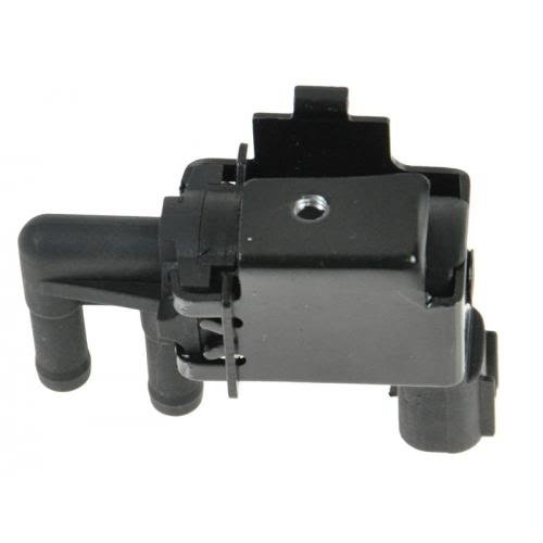

    EVAP purge valve? :notsure: My wife's Honda made some pretty loud clicking/rattling sounds until I replaced it. It's not detrimental to the engine or anything when it gets to that point, just annoying.

    hmm interesting, did it have the same symptoms? i wonder where that would be on a 2.4 1st gen. Thanks very much for the help though, i'll check it out and report back in!!
    would this be the culprit?

    so i did the mod and it turned out to not be the vsv/purge valve.
