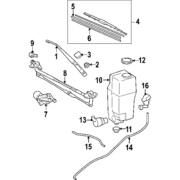

    My drivers side windshield wiper is shuttering vibrating towards the end of its path. I have the original arms and wiper blades, and have only been buying the rubber inserts for the blades.
    Over the years of using the wipers as a snow removal tool this was bound to happen...
    My question is, is the arm bent $50 (part #1) or just the wiper blade $20 (part #4) I’m thinking it’s just the wiper blade but what do you think?
