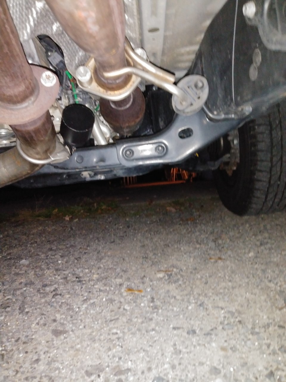

    Its held on to the exhaust by a regular oldstyle exhaust clamp...it’s not attached to the transmission. Screenshot the photo and blow it up you’ll see. It’s actually a factory Toyota part (the damper not the clamp can’t recall if it was from a Toyota highlander or Lexus.

    Can you send link and or pic of this mass damper ???

    I just bought it and installed it last night.i can def tell a difference...i put it right after the drivers side pipe crosses under the t case.i want to buy atleast one more and put it before the muffler ... I now have hope again for this truck...i still have the shuddering/pulsation when braking which I hope to solve soon.i was about to trade this thing is bc my hands and feet were becoming tingly after driving but hoping one more of these things make it even better...thanks for the info and the link.ive spread the word on other threads in hopes that others find comfort in it too.20211020_185148.jpg
