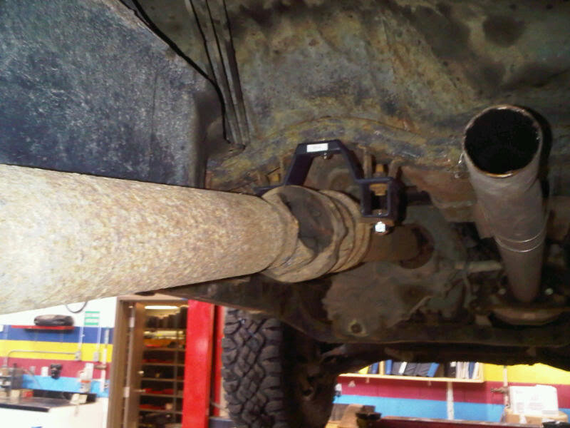

    i dropped the carrier bearing about 1/2 inch, still nothing changed.
    here are some pics of the cv's

    Alright, I took it back to the installer today and he checked the tires, they're fine. the installers came to the conclusion that the cv's might still be at too steep of an angle, creating the vibe, even with the diff drop. I can't lower the front diff anymore because of the crossmember
    (posted some pics of cv's previously on this thread, what do yall think?)
    And if they are still too steep? is there another front lift or setup besides the spacers that would decrease the angle on the cv's

    They're right, those things look like they're at a horrible angle. Only option is to either go with a lower lift or add heavier skids and a heavy ass bumper.

    You got a pic that shows the upper part of the strut and also a close up of the spring perch. Something isn't right here. That is too much axle angle for 5100s alone.
    Is the spring perch installed upside down? Do you have a lift spacer on top of the coil?

    yeah i have a 3in spacer on top of the coil and which is apparently too much for the cv's
    do you still think something is wrong? or is it just simply the spacers causing this?
    i mean i had read numerous places where you could go up to a 3in lift without having angle issues and problems like this
