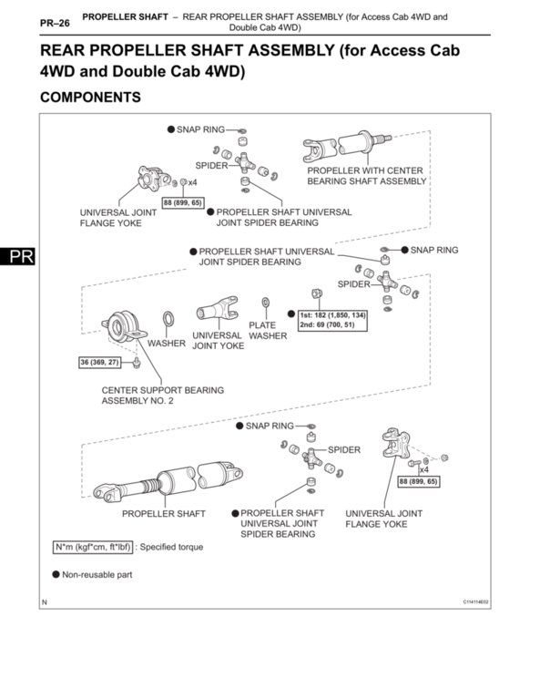

    Yes. It sounds like you might need a new CB. Could test by removing the rear driveshaft as @hx989 said. When I did mine it had maybe 3/8 of an inch of play up/ down I pushed up on it. Swapping it out made a huge difference, then the needle bearing gave out a few months later haha :rolleyes:
    See my posts below for some info on the process as well as part numbers.

    This may be the problem because my center bear has a good bit of play up and down but I though that was normal.
    Im going to 1) check balance 2) change CB
    Would you mind sending me a link or part # for 2007 4.0L V6.
