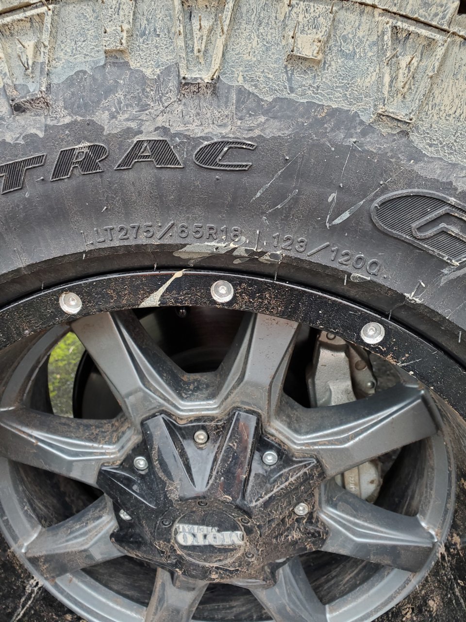

    So i have a 2020 Trd offroad that has 4k miles on it and I installed some 18x10 wheels with some goodyear duratrac 275/65's on them and have been balanced more than once and still having vibrations above 45mph. I also have front bilstein 6112s on it set at about 1.5" lift with completely stock rear. I also drove it in 4H up to 50 and nothing was changed. It has constant vibrations on the freeway. Do u guys know what the issue could possibly be? Thanks
    Also the front 2 are brand new and rear 2 are about 60-70 percent tread.

    I would still say balance. Boy, that's a wide wheel for a 275. Also what wheel do you have on their? Is it hub centric? Spec's of wheel would help.

    I have vibration in the seat. I will start with replacing the needle bearings they are moto metal M0970 wheels and I got them balanced at a reputable shop and just got them balanced again today at discount tire..
    The wheels are hub centric, bought them new at discount tire

    In process of rotation rn, -24mm offset. Vibration is same with new front tires
