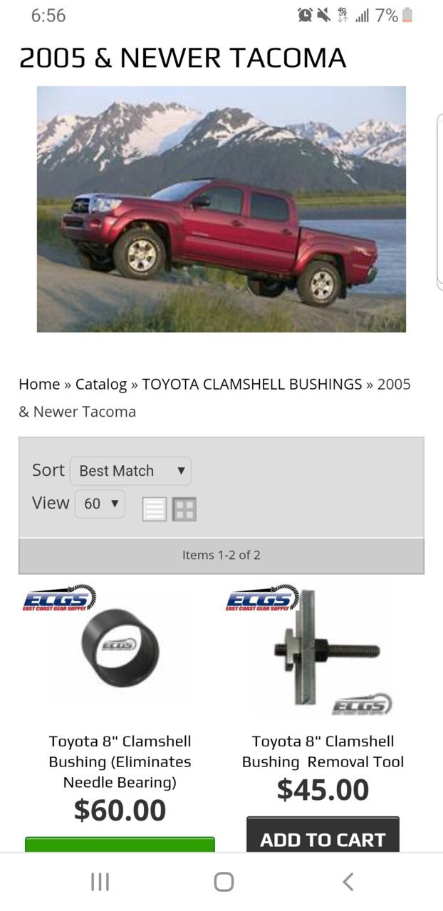

    He's talking about replacing 1 needle bearing. Not the wheel bearings, just in case you didn't see that. :thumbsup:

    9
    Bradley
    1999 Toyota Tacoma
    Just replace the drivers side needle bearing? I rotated my tires and vibration hasn't changed..

    This may not correct your issue. But in my opinion it would be a good next step and it might fix your vibrations.
    Ecgs (east coast gear supply) is the company. You can call them or just order online. I ordered both of these and that's all I needed.

    Okay I'll order the bushing and removal tool soon as I'll be able too, thanks!

    Might not fix it but going to a 3" lift eventually so might as well replace it
