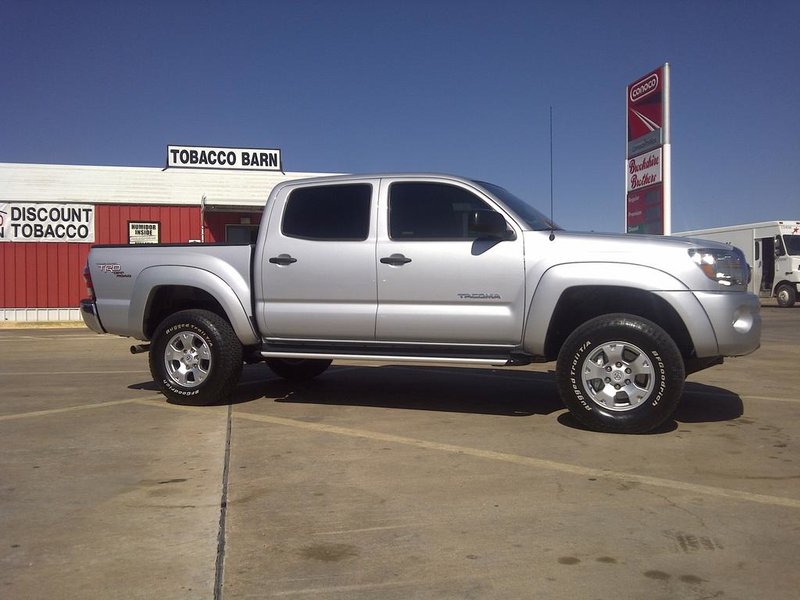

    Ok I had the same problem you guys were having on my new truck. Shit was such a pain in the neck trying to track this one down. Finally they installed two new tires on the back and road forced balanced the tires. I kid you not when the service manager got out my truck and said " I can't believe how much of difference that made...." So in closing my truck is FIXED!!!!!

    No I can promise you these are new tires. All I know is I am very particular with my cars and now mine is finally perfect!

    It's either not the same issue or it's going to come back. I played with my carrier bearing a bit last weekend and it initially felt better but I think now it's worse than it was before after a few hundred miles. Back to the drawing board! I'm going to take the washers out and put a strip of rubber between the carrier bearing mount and the bearing next. Probably won't help but it's only 2 bolts.

    Either way man but I have 400 miles on it now and still smooth as the 2011 Camry we bought the same day :)
