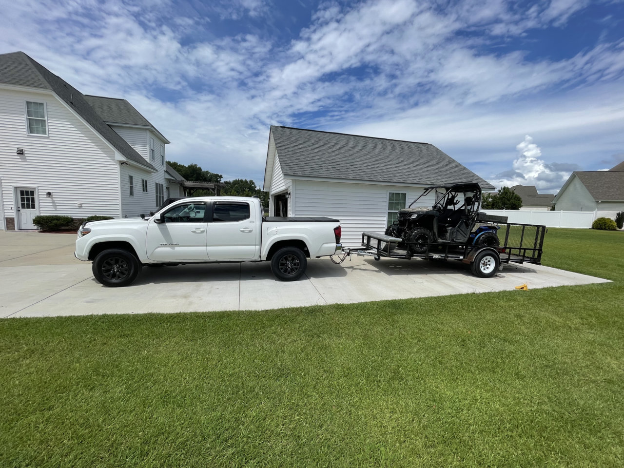

    2021 Tacoma SR5 4x4 Double Cab Short Bed
    I was able to hook up my trailer and Pioneer 500 to put some weight on the hitch. I didn't feel the vibe hardly at all so I am going to cancel the service appt and try and give it some time. Thanks everyone for the advice. It rode so much better with 200lbs on the hitch.
