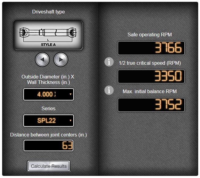

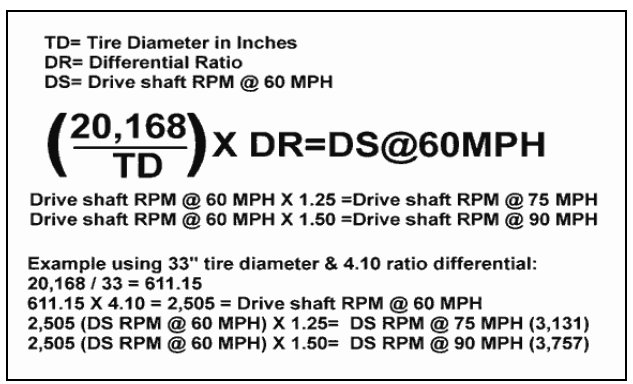

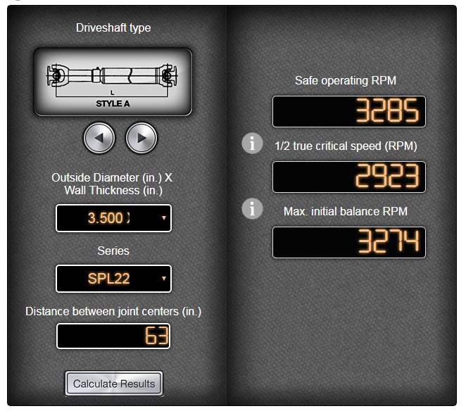

    Well, I'mm guess your Drive Shaft is 67.5 flange to flange, so lets say 63 joint to joint. using the spicer calculator http://spicerparts.com/calculators/driveshaft-safe-operating-rpm-calculator you can calculate safe speed. You will need to calculate the shaft RPM based on tire diameter and gear ratio. See spreadsheet for tire size and gear ratio.
    I was thinking about doing a one piece for my DCSB but that would limit me to 75 to 80 depending on driveshaft size.
    So depending on if you have a 3.5" or 4" shaft the safe RPM could be 3200 to 3766.
    The spicer tool does have some safety factor built in so i don't think your drive shaft will explode if you exceed that number but you will get vibration.
    This is why i am going down the road of a custom 2 piece.
