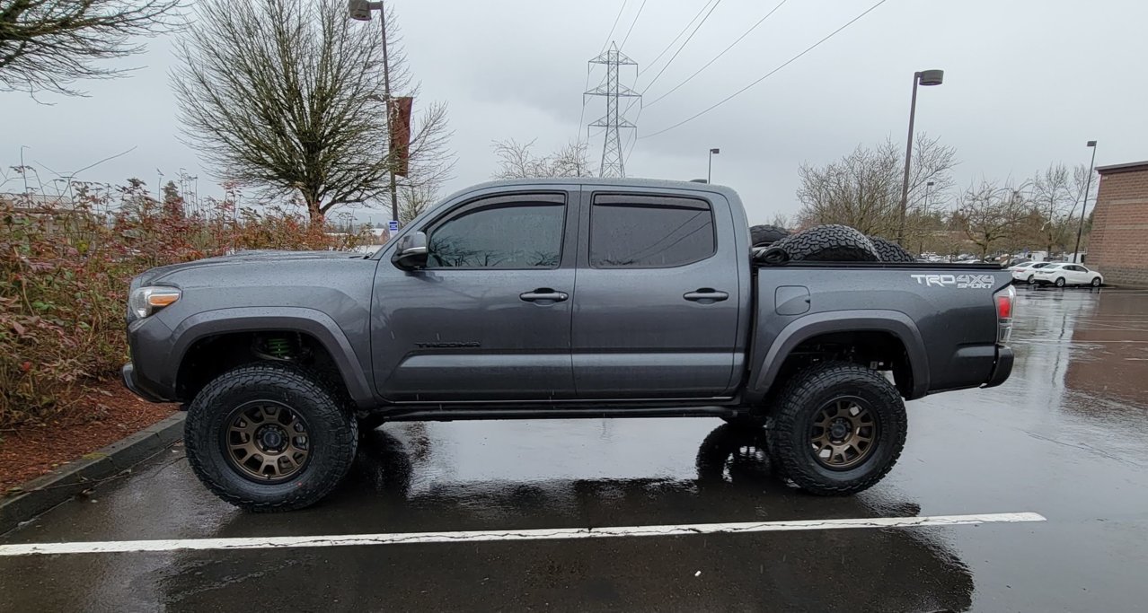

    Hello,
    I have 2021 TRD Sport with a 3 inch Ironman 4x4 Foam Cell Pro lift. After getting the lift, there seems to be a vibration coming from the driver side front wheel area. The vibration frequency increases with speed. I had looked up what could cause this issue and found that unbalanced tires are usually the cause for such vibrations.
    Well, I got new tires and wheels on the truck, and they where balanced upon installation. However, the vibration still happens. This has me a bit stumped and I am seeking advice from the community regarding this situation.
    Part of me thinks it might be the drive shaft and I will need to do a drop.
    Open for suggestions on troubleshooting the problem and comments if other have experienced something like this.

    How did it navigate that mall parking lot

    Cool stuff
    That’s a big lift you got there
