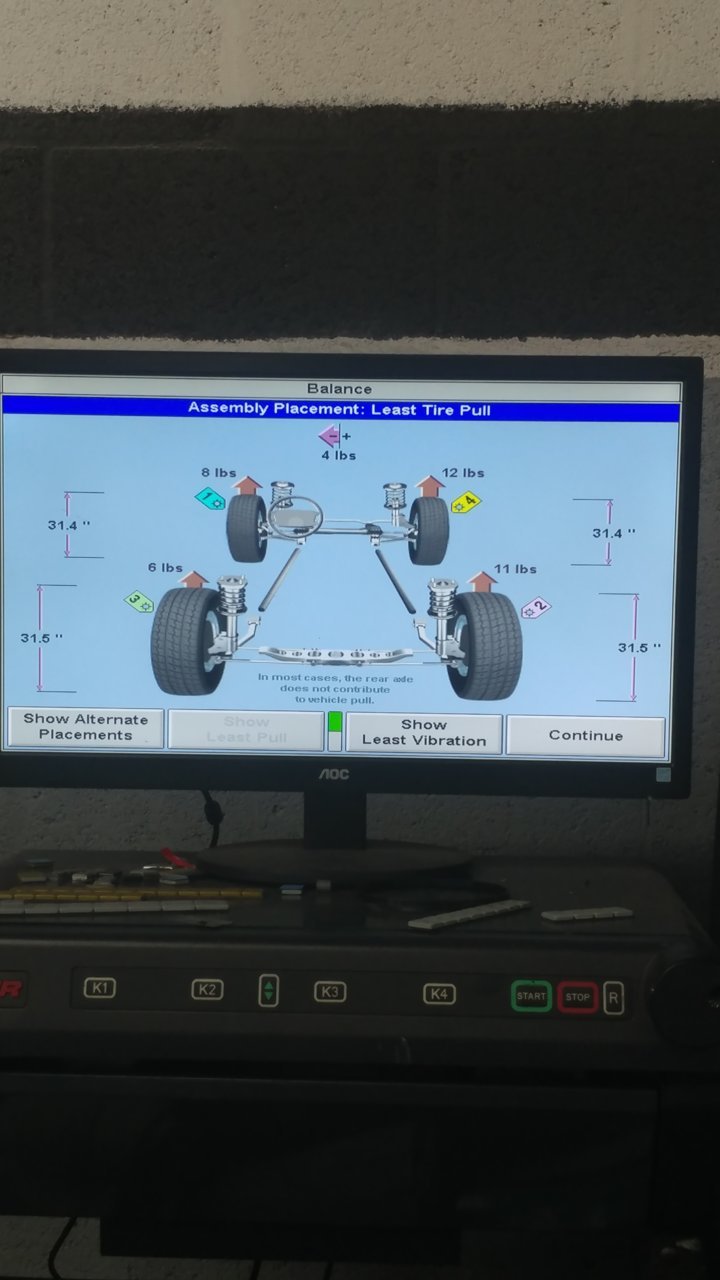

    Yep, SL rated which is why I am even more frustrated. These should be GTG.

    Where are located? A lot of shops claim to road force but have no idea how to do it properly and your concern is EXACTLY the description of a botched road force job. I have 285/70R17 RG SLs and I was able to force match them all under 12lbs. When I do my first rotation I am going to re check them to see where they are.

    Yeah, my steering wheel is centered, which is why I think it is a tire issue. I really hope it isn’t the ghost “vibration” issue I am now reading about with the Tacomas. That is just unsat for a vehicle after 2000.

    How many miles do you have on your RG's? Any sign of cupping? Mine had outside cupping in less than 2k miles, even after multiple balance and rotation attempts. Yes, alignment and shocks checked out ok. But multiple replacement tires seemed to be out of round but Nitto still won't warranty them.

    I wish you the best man, there is nothing more frustrating then having a newer vehicle and being at the mercy of clowns that don't know what they are doing. I'm fairly convinced many of the issues many of us have regardless of brand is actually installation error and sloppiness.
    Look around the forums and see how often people are not only having balancing issues, but also get to deal with chipped, scratched, and scuffed wheels they just dropped 1k+ on in addition to that new set of tires. Road force balancing is a fairly "new" thing in terms of how wheels have historically been balanced. I'm not saying it isn't useful - obviously a very useful and modern tool for wheel balance when used in capable and understanding hands. Capable and understanding hands seems to be the lacking common denominator. Even at the dealer, you think a master tech is changing oil, balancing tires, and doing alignments? Rarely, if ever.

    Put them on the truck at 83 miles. Right now, have 544 miles on them. No cupping or any signs of abnormal wear. My concern is getting another set of Nittos that are out of round and I am stuck with them with no warranty. Hence why I am looking at the Toyos.
