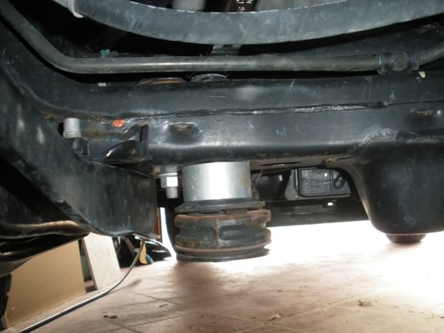

    I have done several vibration experiments with my lifted 07. The factory torque specification for the the 2 Front Differential bolts is 101 Ft/Lbs according to my 06 Factory manual. That's tight, I mean really tight but important. My Toytec Diff drop instructions said 50-70 Ft/Lbs or torque to factory specs.
    Round 1
    With the Diff Drop installed and the bolts torqued to 70 Ft/Lbs, the vibes vary but are rather intense around 40 and 60 mph, making driving the truck less than an enjoyable experience. At 90 Ft/Lbs the vibes were still fairly intense at primary cruising speed of 65 Mph. Not good.
    Round 2
    With the Diff Drop removed and the bolts torqued to 101 Ft/lbs, the vibes were much less noticeable so I was definately heading in the right direction. Now comes my 2 foot breaker bar. After torqueing beyond 101 Ft/Lbs with the breaker bar, said bar was bending and had me concerned it would snap, I estimate I torqued to about 110-115 Ft/Lbs. At that torque, my only vibe is around 40-45 Mph and is not very noticeable. In fact, it drives about as smooth as it did before I embarked on my Diff Drop weekend project.
    In hindsight, I recall my breaker bar bending severely when I broke the bolts initially but I thought it was thread locker. In my manual, I saw no reference to using thread locker so I did not use it. I think I'm close to the original torque level now and am happy with it. I will probably recheck the bolts next weekend.
    My Lift and Drivetrain Specs:
    Icon Coil Overs cranked to 2.5" of Lift, Factory UCA, No Sway Bar, AAL plus 3 degree shims, 1-piece Tom Woods Drive Shaft.
    Pics:
    Even though the spacer shown is 1", it does not provide 1" of drop, or any significant amount of drop on the Front Differential. It does change the angle slightly. I had the Diff Drop kit in a lifted 05 and pulled it out for similar vibration issues but thought I'd experiment on my 07. Lesson learned, no Diff Drop for me and check the torque on the bolts meets factory specifications.
