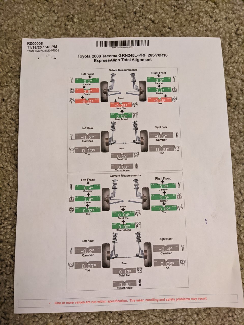

    Alignment looks fine to me, but it wouldn't be the cause of your new vibrations anyway. @Muddinfun is a better interpreter of alignment sheets though. Running a higher caster is totally up to you. Not worth going back and paying again just to bump it up a degree imo. Next time around you can ask them to aim for 3.5*.

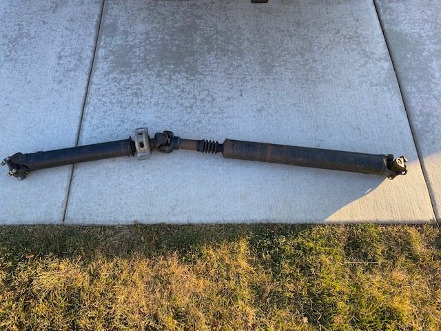

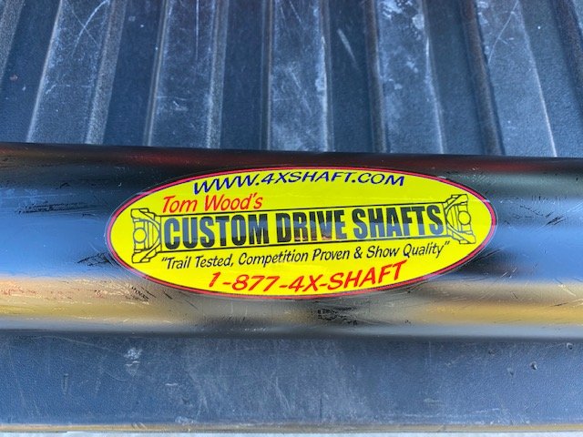

    So after much deliberation and research and multiple personal and professional opinions I decided to go with a custom built drive shaft from Tom Woods. This drive shaft got a lot of good reviews. I will be driving this vehicle for a long time. I just spent enough money to upgrade my entire suspension so why not upgrade the driveshaft. In the long run I think it will be the best decision. This should take care of the vibes, eliminate the carrier bearing, and these drive shafts are supposed to be a lot better quality than the factory ones as well. I will let you guys know how it works out and I appreciate all the advice.

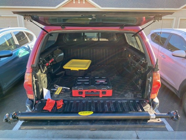

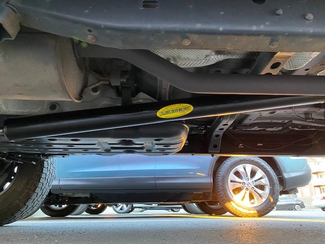

    So as I said before I went the best route for me. I will be driving this truck a long time and if I have the chance to upgrade something that will be beneficial in the long term I will. Decided to not mess with the angles and the BS carrier bearing. Went with a Tom woods one piece drive shaft. This thing is solid! Easy to swap out. 1 day lead time and 2 day shipping! All vibes are gone! Love this thing and super glad I did it.
