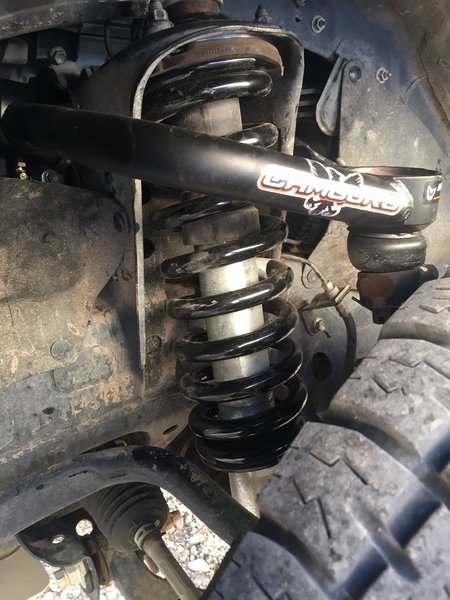

    Hey guys, I just installed new OME 885's on my 5100's on the lowest setting and new Camburg uca's. After the install there wasn't any vibration of any sorts. Next day I went in to commercial tire and got and alignment done. Next day my front end has a vibration similar to the feel of mud tires. I have no clue what it is. Is there any insight of what it might be? Love to hear any ideas people might have.

    Everything torqued to spec? I feel like the ball joint boot needs to be more squished like this one....

    Driver side bearing in the front diff - needle bearing. super common. Mine made that rhythmic hum for about 12k miles before I replaced it with the ECGS bushing. If the sound goes away in 4wd, there's your culprit.

    Tried the 4wd drive and its still there. Is there a way to release the grease from the ball joint?

    Are you sure its torqed to spec?

    Not positive. I could only go up to 100lbs with my torque wrench. But everything feels tight and nothing's lose.
