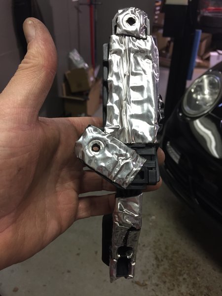

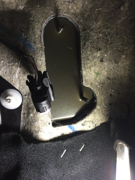

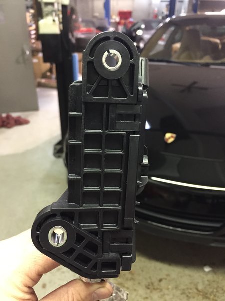

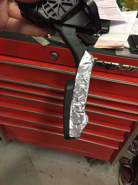

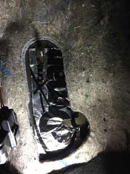

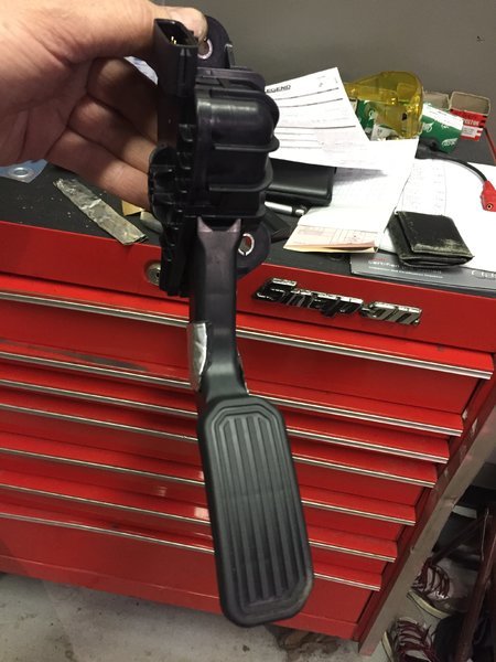

    @ 500 miles on my 17 DCLB Auto TRD Off Road i removed the gas pedal actuator and wrapped the back and sides with some Dynamat i had leftover from an old speaker install. Very pleased with my results and while the vibes are still there it seriously dampened the frequency of the buzz. About 5 days later and i am no longer hyper sensitive to the incident. I had been researching my purchase for a year so i was well aware of this incident and picked up on it the first full day i drove it. No more toe tickling! I also applied the material to the bare bulkhead behind the pedal assembly.[​IMG] [​IMG] [​IMG] [​IMG] [​IMG] [​IMG] [​IMG] [​IMG]

    dont over tighten the nuts when re installing and youll be fine. dont turn ignition on with pedal disconnected and you wont set any faults. 31k and still happy.

    moments ago i took my gas pedal off, which took 3 minutes, then took a piece of paper and trace the outline of the pedal, cut it out as a ghetto template and cut an old thin yoga mat piece to match it, put it under the pedal where it was simply held in place by the two studs for the nuts, put pedal back on and the pedal vibes seem better right away. i didn't even go as far as unplugging the electronic connection as there was plenty of room to work. a very simple thing you could try for possibly no cost if you have something you can put under the pedal that will absorb the vibes. time will tell if this really works. i suspect i will end up pulling the carpet and using some dynomat on the whole driver side floor eventually.

    Do you have pictures of how you applied it and where? Is it just like the guy that wrapped his in dynamat?
