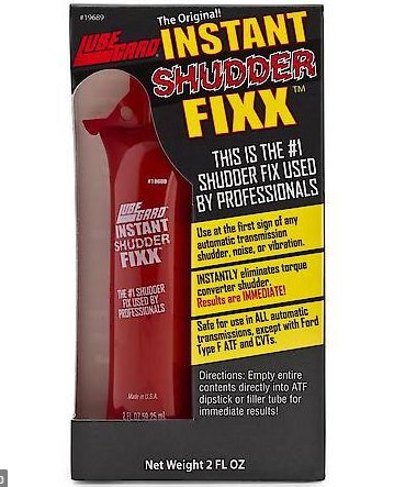

    Sounds like what you're experiencing is torque converter shudder. My 06 was doing it at 200k miles so I drained the transmission pan and refilled with Toyota fluid along with a couple of tubes of Dr Tranny Instant Shudder fix and problem went away.

    Dude that sounds like exactly what I'm experiencing. I'm positive it's got something to do with the tranny somehow. I think torque converter shudder maybe the next thing to try and hunt down. I did a tranny flush in it but I didn't use toyota fluid, I just used O'Reilly's finest... Maybe that's where I went wrong???

    To eliminate the transmission and torque converter , try a brake tap test .
    Incredibly easy to diagnose !!!!!!
    You wont get good results by simply adding shudder fix to your dirty transmission fluid . There is a specific procedure to follow for best results . Taking the transmission pan off for a contamination inspection is the first step
    When was your last engine tune up ? spark plugs and throttle body cleaning ? air filter ? Cam screens ? Everybody blames the torque converter because its what you feel in the drivers seat when the converter locks directly to your terrible running engine

    That's very interesting! That definitely sounds like what I'm experiencing. I did a tranny flush on it about a week ago but I didn't use Toyota fluid, I just used O'Reilly's fluid. I'll try another flush and use proper fluid this time. Where did you get that Dr Tranny shudder fix from? Is that an actual fluid ??

    You can find them at Advance Auto Parts and come in little 2 oz tubes. You might find them at other parts stores. Worked like a charm. Shudder disappeared almost instantly. Make sure you use the Toyota WS fluid. Not sure how these transmission will react to other fluids.

    Is that stuff good to use or does it do damage to the transmission components over time? I'd be inclined to do an actual repair, but that might be out of your budget. Perhaps the secret is to use it to test it and then flush it if it works or doesn't work and repair the tranny if the budget is there?
