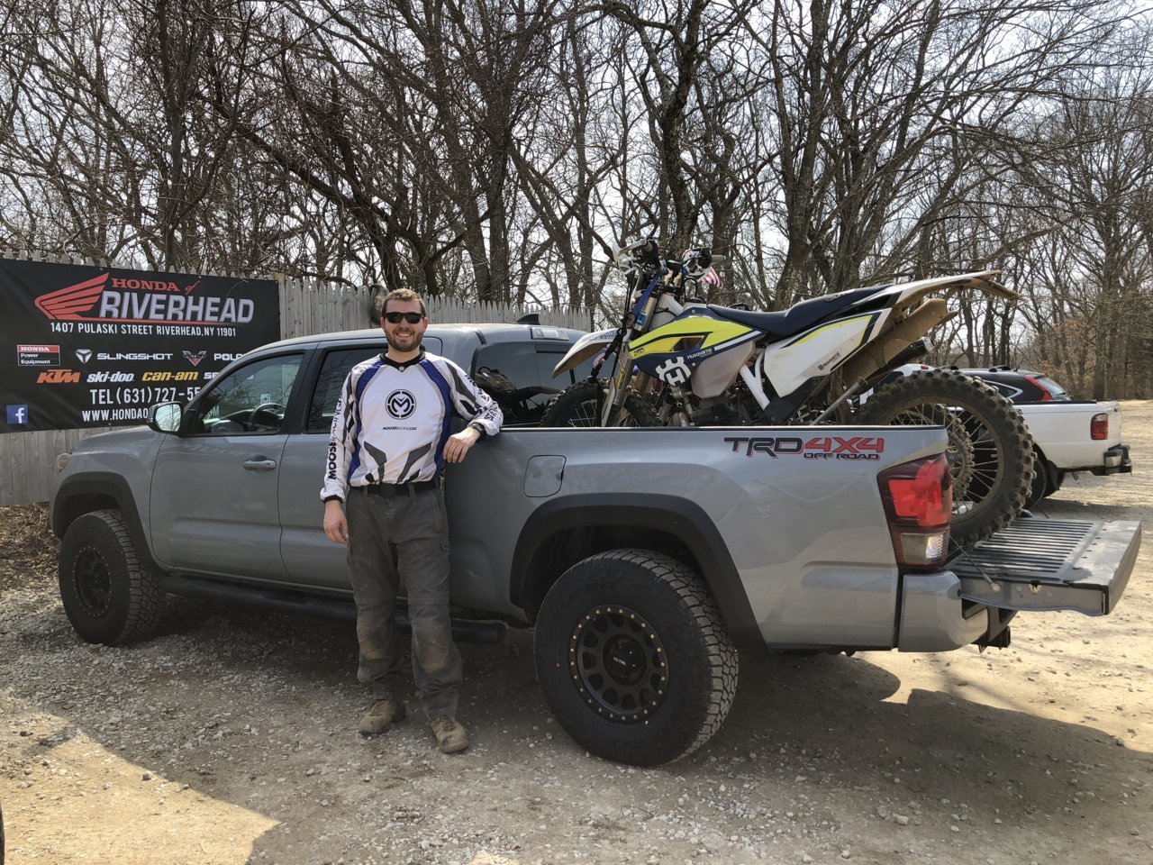

    Finally got my methods and wildpeaks mounted and they look great! Only problem is I have a vibration at highway speeds now. I have had the tires completely rebalanced including doing a “road force” balance on a newer hunter machine and although better I still have a slight shimmy over 60mph. Any ideas? Could it be the lugs nuts I got from Amazon?
    One of the assemblies took 200grams, one took 100grams and the last 2 about 50grams. Yes I know it’s weird saying grams as far as wheels weights are concerned, but I work at a BMW shop and everything is metric!
    DPAccessories D5246P-2308/24 24 Black 12x1.5 Closed End Spline Tuner Lug Nuts for Aft... https://www.amazon.com/dp/B00JH1HODY/ref=cm_sw_r_sms_apip_9JF8qrGHfbJwi
