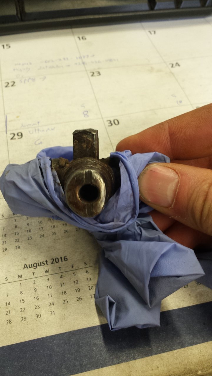

    You check your U-joints? That's pretty much what mine did when the u-joint was toast.

    :thumbsup: agreed. Especially since you get the clunk when first stepping on gas.

    Here is what mine looked like when I got the truck. The cap was busted and no needle bearings were there. This was just clunking around in the yoke.
