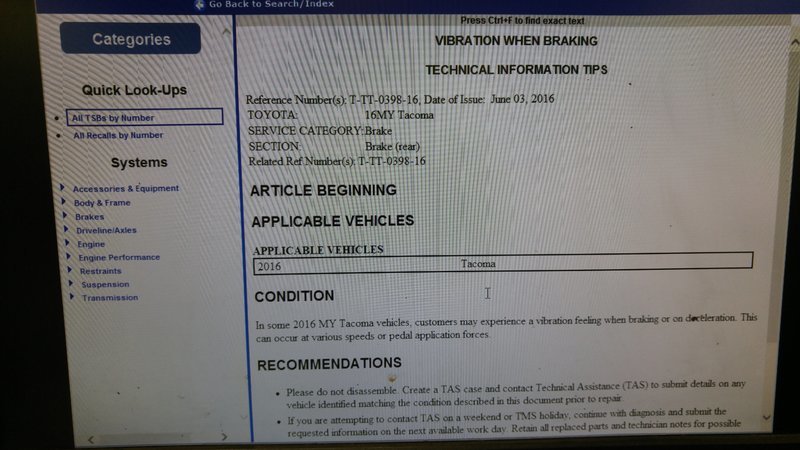

    Hope this helps not alot of info but has a reference number

    Anyone have any luck with the above TSB reference? does this lead to having you're leafs changed?
    The few people here who've gotten their rumble fixed (bulldog...etc....) via leafs/damper, seemed case by case, but if there's a TSB reference, maybe we all can get some traction.

    Picking up my truck in an hour after a full leaf replacement..
    No TSB just told em' it's bullshit and they agreed. Service manager was trigger happy on anything warrantable.
    If and when it squeaks under warranty i'll be in for another replacement.
