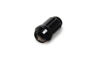

    What kind of lug nuts does your wheels have now?

    Totally depends on rims, but mine require a deep shank, not just tapered.
    Last time I pulled a wheel, I realized someone put one of your style on the last time i was at the dealership. They musta lost one of mine.

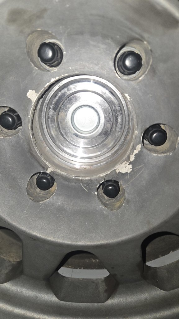

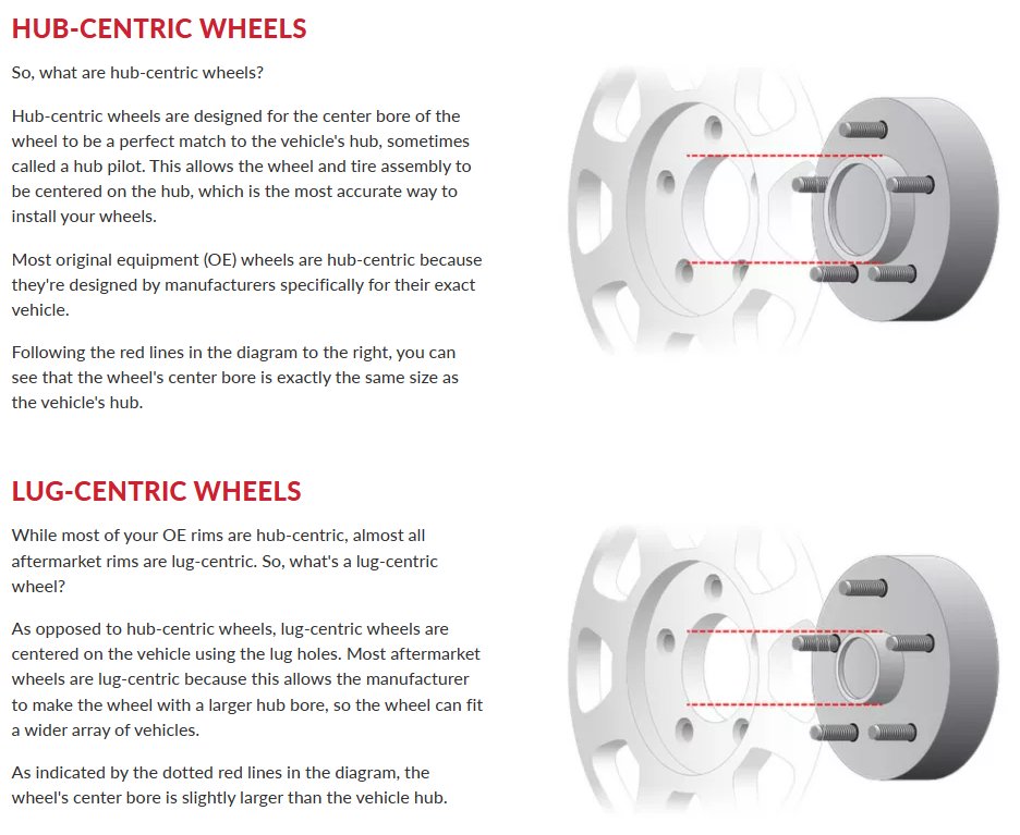

    I can’t answer that one…Is the center bore of the wheels larger than the hub?

    Idk if you can see it here but it seems to be pretty close to the size of the hub center. There is a little gap that I can see on the inside.
