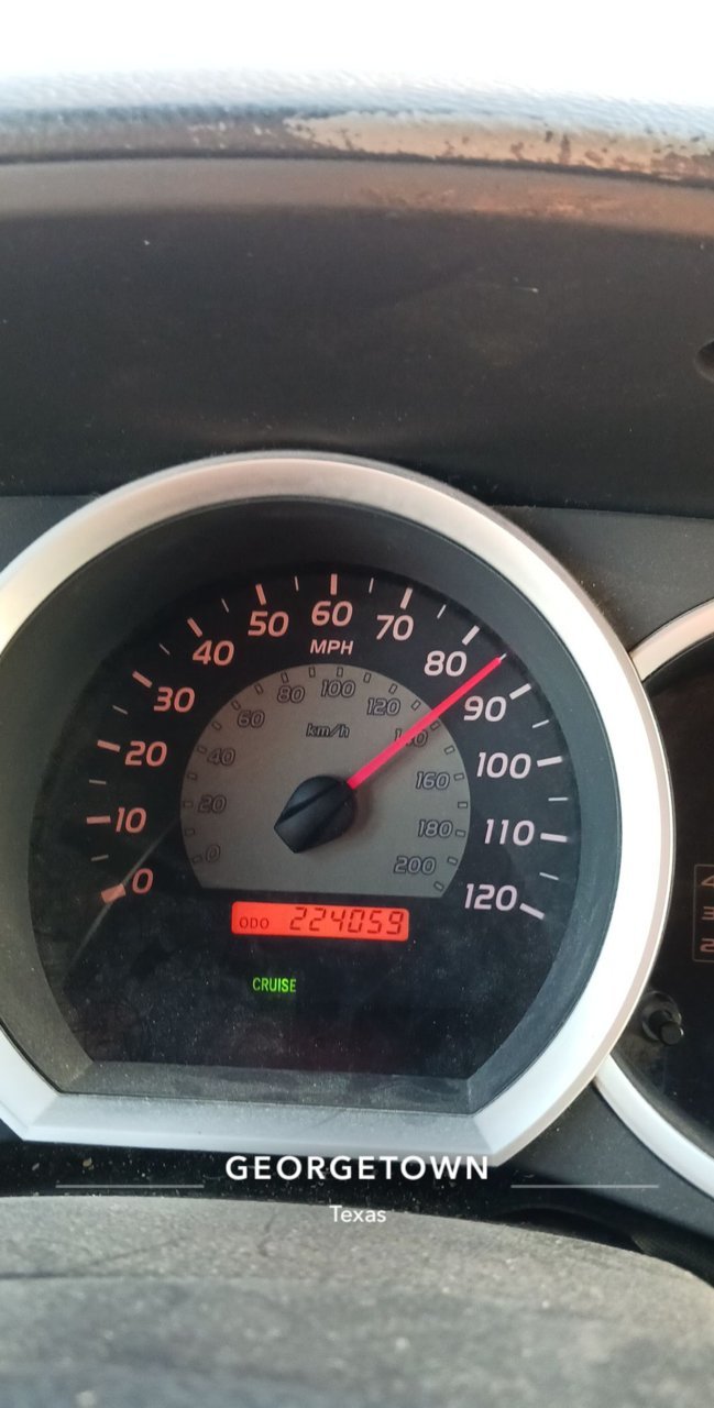

    My o8 Taco, now has 224000 miles on it and is getting a vibration around 40 MPH when I slowly accelerate.
    No vibration at highway speeds up to 90mph.
    I did a search and from what I've read on here and other YouTube videos, it seems to be the holder bearing to the 2 piece driveshaft
    I didn't feel like doing all that crawling around under my truck, so I took it to the local dealership.
    They are trying to tell me it's the the torque converter when it's trying to "lock in".
    I told them just to change the transmission and differential fluids.
    I can't see spending that amount on it, when I hope to sell it next yr after I retire.
    I'll just accelerate heavy and skip the "vibration zone".
    I still say it's in the drive shaft area. There is movement in the holder bearing when I crab the driveshaft and shake it.
    If I get the whole complete drive shaft assembly, should it all "balance out" ok with just swapping em out?
    Attached is an image of a smooth ride, the evening before taking the truck to the dealership.
