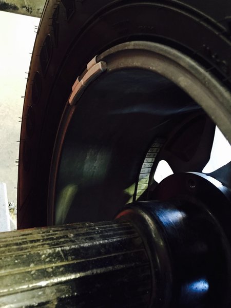

    drove my TRD OR back from Colorado and noticed a pretty significant vibration between 75 and 77 mph. Instead of driving out to the dealer in traffic I decided to go to my neighborhood Discount Tire. Look how much weight was on the rim and inner wheel from the factory! They're trying to rebalance it now with less weight. If they can't I'm going to the dealer for a new tire. image.jpg

    You would think that when they were matching wheels to tires at the factory they would say to themselves "that's too much weight, I'll put this tire in the pile we're sending back to Goodyear."

    It's definitely the tires. There was a ton of weight on there.

    I'm at the dealer right now and have the exact same issue. Service guy just came out and said there's a ton of weight on 2 of the tires. So they're taking all of them off and are going to rebalance all the tires!

    I'm at the dealer now too. Already tried that at discount tire yesterday. If it needs that much weight the tire is defective in my opinion. If they come back to me with the same solution they came to you with I'm just going to tell them to replace the tire. Moving that much weight around is not a solution.

    Update: still at the dealer. Rebalanced and rotated. 6oz of weight on one tire! Service foreman says he can't replace tire, going to try to force match it or some shit and then rebalance. I told him there is no way that's not a defective tire if it takes 6oz to balance and the others take a half oz or a few grams. His response: "the computer says its balanced so I can't replace the tire" then "it is a truck you know". I told him not to start down that road with me. About to tell this dealer go eat a d*ck. how are you fairing Aaron?

    Well, they just tried to road force balance it and were not able to get it within specs so it turns out the tire was defective. New one doesn't arrive until Friday but I don't have any hwy trips before then. Dealer came through.
