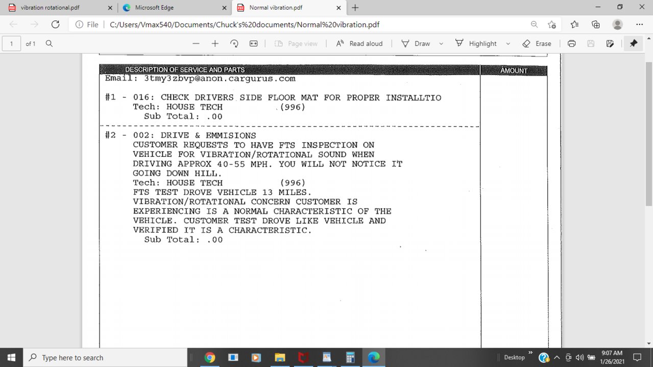

    Just, a Normal characteristic of the Tacoma...
